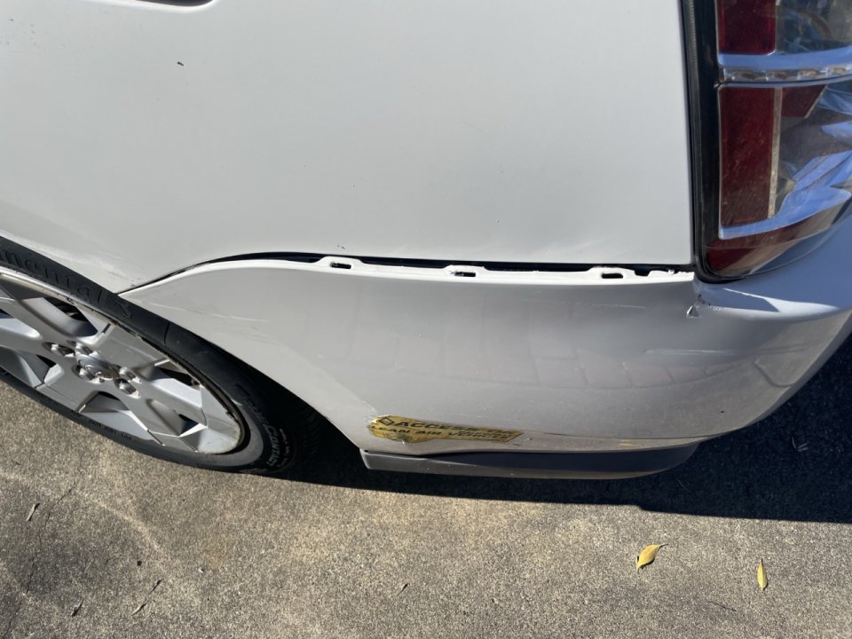

    Hi. two questions:[​IMG]
    1. Does anyone know the part number for these clips? (2006, if it matters/)
    2. Do I have to remove the entire bumper in order to install them?
    Thanks a lot.
  2. Tombukt2
    Tombukt2 Senior Member
    Nov 29, 2020
    13,809
    2,504
    Durham NC
