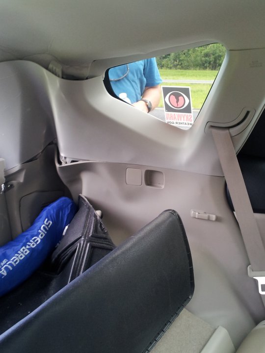

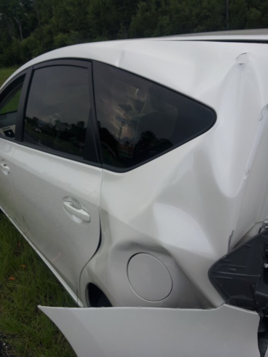

    Looking for advice and words of wisdom.
    How do I fix this mess?
    One collision center fixes unibody frames by straightening the frame on a frame machine and the other collision center removes the damaged section of frame and welds a new frame part into place. Which is a better option and ensures the same frame integrity hence, safety) as before the accident?

    Sanford, NC
    My concern would be the safety in a similar crash of the repaired vehicle. The metal in the body and structural elements, once deformed, lose their strength and would deform very differently the next time it got hit there and the liability to anyone who repaired a vehicle in that unlikely occurrence would be enormous. I wouldn't want to drive it.
    My one experience was an accident my attention to something else caused and I immediately thought it would cost $5k to fix my car. The body shop stopped counting at $26k and the insurance actually paid me more than I had paid for the car 4 months earlier. The car was drivable after the accident and I didn't detect any suspension damage.
    Let them pay for you to get a new car with a crash structure as it came from the factory.

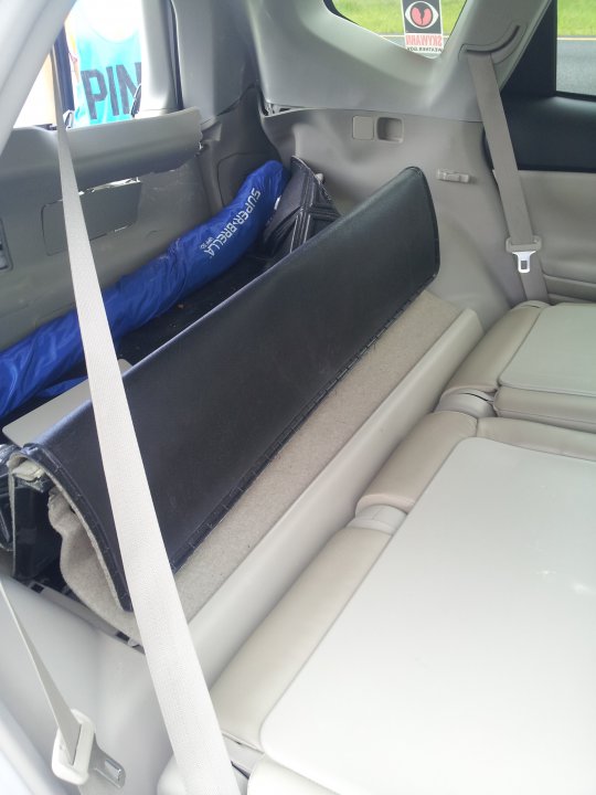

    First off, glad you are OK. Toyota's engineering is superb and the car is meant to wrinkle. Most people assume a car that looks destroyed after impact is cheaply made, and the one that has minimal damage is better made. This is completely false. Toyota and Honda design their vehicles to be safe in impacts both between other vehicles and humans. The hood is made specially so that if you hid a pedestrian it will cushion the blow and direct the human off to the side of the vehicle instead of ahead to be run over by the still moving car. Likewise the front and back end are made to crumple (hence "crumple zones") so that the energy of the accident goes into deforming the metal and not into deforming you the human that can't take as much stress as steel.
    So A+ to Toyota.
    Now I have bad news. That car needs to be totalled. Fight for it to be totalled. You say that the driver door does not close. The damage went through the back pillars and roof and into the A pillars at a minimum. Basically every panel on the car except the fenders and hood needs to be replaced and repainted. My gut tells me that you have frame damage as well with the way the car is crooked.
    Another piece of bad news is that your 12v battery has been crushed. It could be leaking sulphuric acid all around your back carpet pieces. Also, it is essentially shorted. The inverter has a 100A (well GenII is 100A, I think GenIII is 120A?) fuse, and if that has blown you have to replace the fusible link in the hood as well.
    And the kicker... Your traction battery is located in the rear, sort of halfway under the rear seat and false floor. So is your spare tire. I see lots of stuff pushed up, but I don't see your spare tire poking through anywhere. Which to me says it went straight forwards. Which means it probably impacted your traction battery. Broken or leaking cells, broken or fractured bus bars, temp sensors, and lots of other things in the battery that are not easily detectable.
    That car needs to be totalled and destroyed. It is no longer road worthy. But you are OK, so count your lucky stars and thank the Toyota engineers. Hopefully another V will be in your future.

    No reputable body shop would ever "repair" damaged crumple zones, everything must be replaced. This can be done if its just one quarter panel damaged, one front corner, etc. To repair this car they essentially need to cut it in half and replace everything. There's just no way that's not going to add up to a new car's price.
