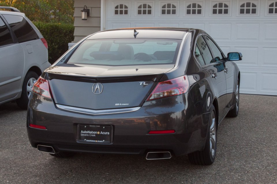

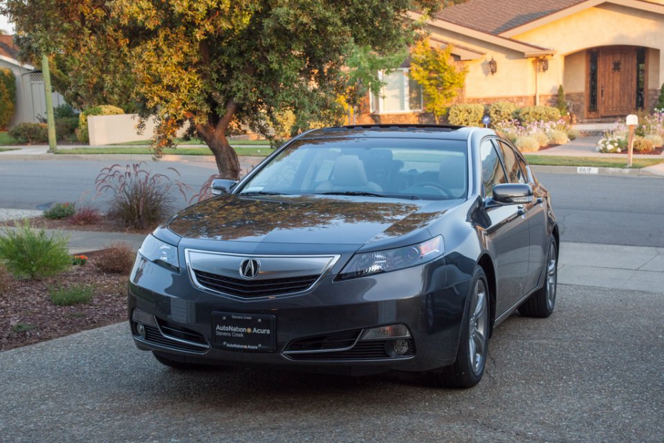

    Something bigger for the safety of my family...
    I was awfully glad that I was alone at the time my Prius was rear-ended.

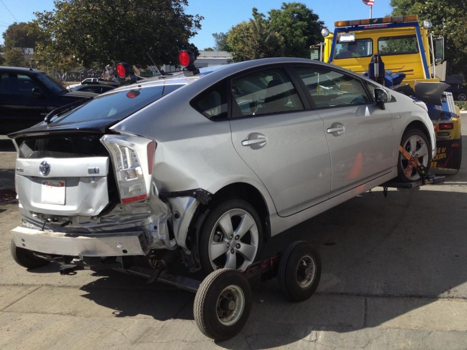

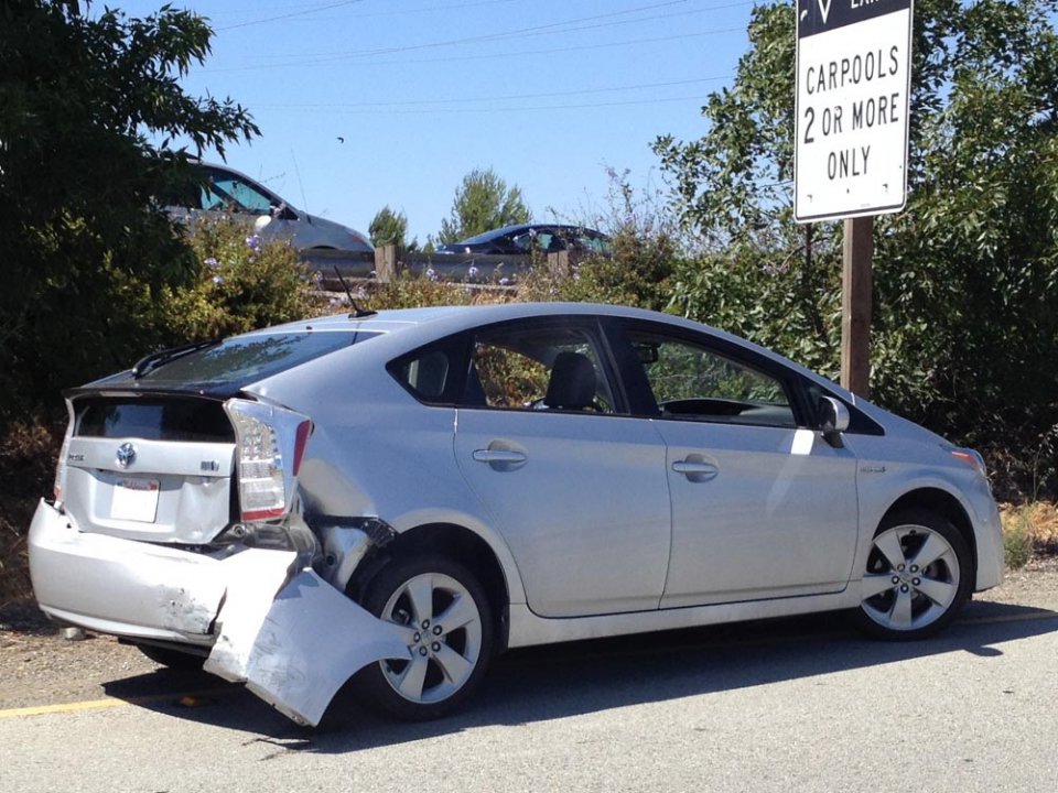

    Responding to the comments above, please consider that I share an educated guess about the damage based on viewing a few photos of the damage. Judging by comments such those above and by comments posted in this thread related to another rear impact to a Prius, How safe is car after rear end collision | Page 2 | PriusChat ...."educated" (informed) comments are rarely posted on these matters.
    Comparing what I posted to the $15,000 plus of a damage report written after a much deeper inspection than what was available in posted pictures.:
    Emotion aside, a total loss is considered if damage is expected to exceed 60 percent of retail value of the damaged vehicle. An
    insured is also entitled to a sales tax allowance in a total loss settlement. KBB shows a 2012 PIP Advanced (I keyed in an estimate of 15,000 miles on the odometer) to be worth $34,300 plus tax. Add on improvements raise the amount of a T/L settlement.
    From standpoints of a T/L calculation, this is a $37,000 plus insurance payout, including adjustments for sales tax and add on improvements by the owner. There is $22,2000, including tax available to restore this Prius to pre-accident condition before
    60 percent of a T/L settlement payout is exceeded.
    The economics I just presented indicate this is a repairable vehicle since there is a cushion above 45 percent to cover the costs of what is not presently justified to be included in the damage report. Repairs are technically feasible, in my experience. Does anyone else posting in this thread have any experience writing damage reports and managing repairs of heavy rear hits of unibody construction?
    Bielinsk posted twice comments made by the person who represented the collsion repair shop evaluating the damage. It seems obvious that person was not trying to sell repair services in this instance even though repairs costs are estimated to be $7000 less than 60 percent of a T/L settlement. The shop does not want to repair this vehicle and the insurance company is not insisting that they repair it.
    BTW, this thread is about a unibody vehicle. There is no frame.
    The design and construction consist of a bolt on subframe in the front of the vehicle cradling the drive train and lower front suspension and steering components. The rest of the vehicle is made up of cleverly designed and folded/bent pieces of sheet metal an extruded sheet welded together to afford energy absorbing crush zones and lightweight structural integrity. The rear of the unibody is similar to a trailer in that it is towed around by the front wheels. In ordrer of repair difficulty and potential post repair complications, heavy damage to the rear is easiest to repair, front damage is second, and heavy side hits are the most challenging.
    This post is intended to be informative, as are my others in this thread. Consider the comments in some of the other posts in this thread and in the ones in the 2012 thread on the same topic I posted a link to early in this post. Emotion, hand wringing, anecdotal and uninformed opinion. Is that what readers of these kind of threads expect to read, or deserve?
    Post about what you know. If you are not, what are you doing?????

    NEinSE - Thank you for your insight. The repair guy said he "could" repair it. But he recommends not to because of the electrical issue he is unable to resolve. He would need to flatbed the traction battery to toyota to evaluate that.
    $15,000 (I haven't seen the damage report, I expect it to be much higher) + $1,900 (add ons) + diminished value of up to 30%, + tax I think easily puts this into TL. The diminished loss is the real kicker here. I made sure when I spoke to my agent that I don't care who hit me, I don't pay the other driver to make me whole, I pay my insurance to make me whole. So I would hold them liable for all damage minus my deductible.
