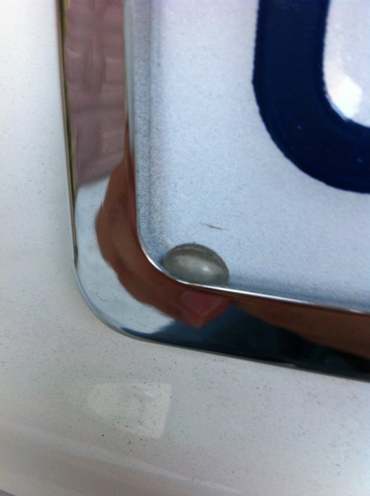

    Sorry for the late reply. I couldn't find any proper "baby bumpers" for the bottom frame holes. I just stuck on two rubber "feet" onto the frame itself. They aren't perfect but the noise has been cut in half.

    I was thinking for the plate itself as well, but it looks like your solution will work.
    TheyCmeNow likes this.
