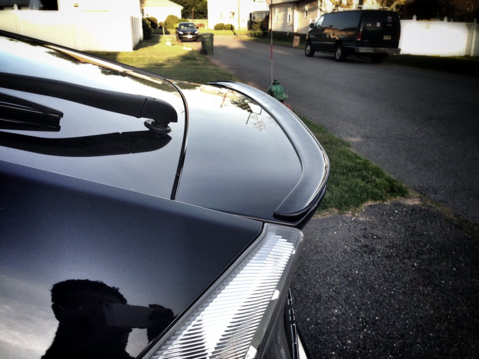

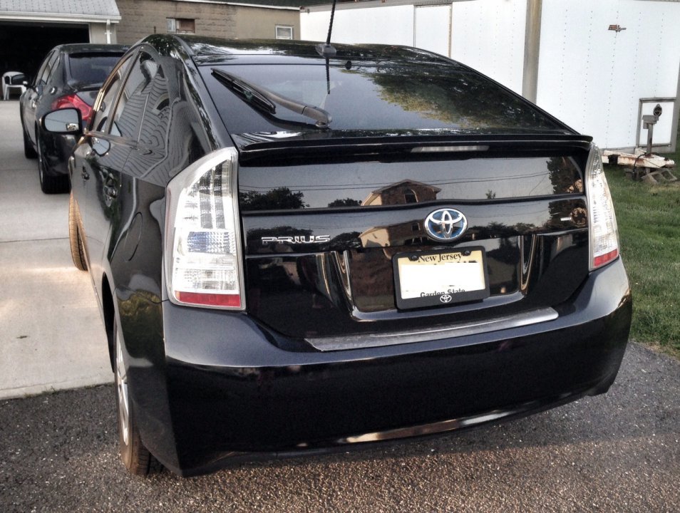

    I got mine today as well, and wow, the spoiler looks straight as an arrow! The color matches well, it does bend, but bending it to the contour of the sides of the trunk seems almost impossible. I emailed the seller to confirm the piece is made for the Gen III Prius just in case. I could take it to a body shop to get it done "professionally" of course, but I just can't figure out another way to get it to fit as it did on that picture, with the spoiler bent around the edges oh so perfectly.

    All of these spoiler types are made out of rubber and when cold they are rather stuff, it is surprising once heated how much they will bend when heat is applied to them.
    I started at 1 end and stuck it, then got the hair dryer on it and worked it along and around, was fine and took me about 10 mins to do.

    Got it installed finally! With the help of my brother, and an unusually hot day, we had the lip spoiler installed and it looks fantastic. We didn't use a hairdryer, since I had left the spoiler inside the car for 2 days, so it was pretty flexible due to the heat. Anyway, highly recommended. Thanks again

    Looks great! It's so surprising how much it can bend once heated isn't it! Looks like you got yours sitting perfect.
