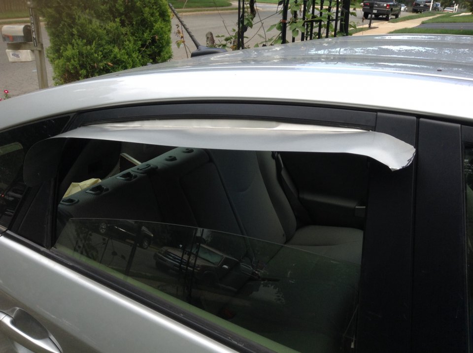

    Having cross-ventilation when camping in the Prius is important, but on our last trip we noticed a problem with the inward-slanting windows in the rain as the rain tends to come inside. That is undesirable in general and especially for the right-rear window, the rain could GO DIRECTLY INTO THE HV BATTERY COOLING AIR INTAKE ! Since that could damage the HV battery, rain infiltration at the right rear MUST be prevented. So from 6-inch wide aluminum flashing I constructed the rain guard below, which inserts into the upper portion of the window's rubber channel and will shield the interior from rain even if the window is left partly open for ventilation (with the screens on , of course):

    Any attachment suggested besides the appropriate bends of the flashing?
    Have you already posted the howto window-screen?
    Attach the screen to the rainguard(s)? Do you also protect the front windows?
    Any other super RVing tricks up your sleeves? :))
    -- nice idea and I like the tent too --

    I was going to use plastic spring clamps on the window frame just under the front and rear to vertically support them. (They seem to fit in the channel well enough that horizontal or lateral movement should not be a problem.) will be testing these shortly. I have made rain guards for the two rear windows and one front from a 6-inch by 10 feet strip of aluminum, but need to buy more to make the last window guard.
