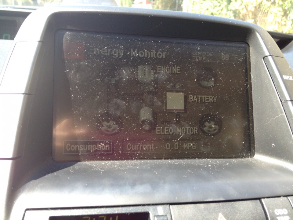

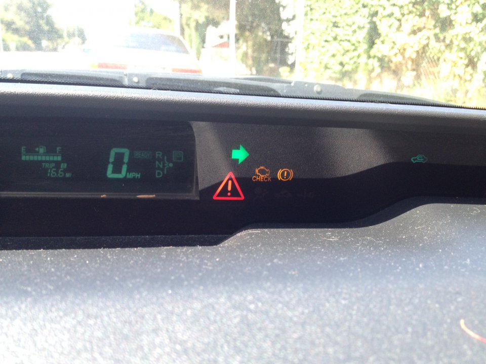

  9. tarawow
    tarawow Junior Member
    Oct 19, 2011
    Los Angeles
    Thanks friendly_jacek, I'm working on it! Ed, attached are pics of the warning lights that came on: red triangle, yellow check engine, and yellow exclamation point on the dash (turn signal is on from me pulling over), plus the red exclamation point on the upper left corner of the digital display. Car was traveling fine then suddenly - no warning of any kind - felt resistance in the accelerator pedal and that the car was 80% unresponsive to my foot on the gas - I'd say probably 10 seconds later all the lights came on and the car was fully unresponsive. From there I coasted and managed to exit an off-ramp.
    Once the car came to a full stop on the surface street, I put it in park, let it sit for a minute, then put it in drive and tried to accelerate again - nothing. I powered the car off, sat for a minute, turned the car back on - the lights came on again (except for the yelow exclamation point). I put the car in drive and it did work, weakly! I managed to drive the 3/4 of a mile home at 15 mph.
    I'd driven 100 miles since picking it up from the dealer a week ago, and, unlike what I posted in my first response, did not feel any sluggishness driving her at any point in the intervening week. Silly me, though that meant maybe we had gotten to the bottom of it!
    Car is at a new dealer now. Will post codes when I get them. And just fyi, here's a brief recap of problems to date:

    Yes you have the car turtle on in the mfd which is 100% hybrid issue. I'm with JC looking like the trans or maybe the Hybrid battery.
    You have to start looking at the battery level in the consumption screen which in this pic shows a very empty battery. Is the fan coming on in
    the back seat?. hard to miss as it is very loud. And watching the consumption screen battery level does it go from full to empty quite fast.
    You've been chasing the engine when in fact the engine may be fine its either you have a bad MG in the trans or the replaced Hybrid battery is bad. The dealer sucks. A quick check with the Toyota Techsteam software and a delta check of the battery will tell you immed. what the deal is
    with the battery.
    The key I think is your first post where you state the car was sluggish with a new Hybrid battery. Thats not good. A new hybrid battery should have made the car feel brand new performance wise.
    When the car feels sluggish you need to watch the hybrid battery charge level. Its probably always really low.
    Btw, what is the history of the car? Bought used? if so please go to Toyota.com/owners and join and post the vin. It will show you every instance where the car was entered into dealer service in the US. That is the Toyota dealer service database. See what led up to the previous owner selling the car.
