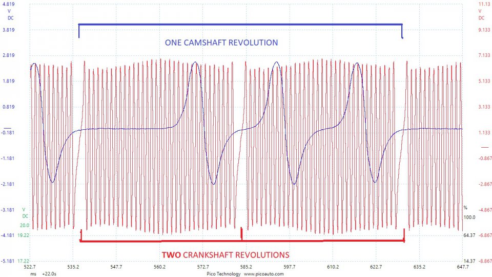

    The claim made for this product has consistently been:
    • (a) it makes valve timing changes happen faster than with the stock valve, and
    • (b) because of (a), happy things with performance and drivability ensue.
    Last Wednesday, mr_guy_mann put up the first (known to me) direct test of whether (a) happens. The test was done by scoping the crankshaft and camshaft sensors, which had already been identified two years earlier as the way it would have to be done. Data from OBD-II would not suit the purpose because of the delays in polling OBD-II and getting replies.
    The work does have (for now) one methodological weakness, small sample size; it was well designed in taking multiple runs with each type of valve, but having purchased only one sample of each type, it cannot (by itself) rule out whether the single sample of any of the valve types was a dud. But it is a very good start on getting some basic information about this product that has been overdue for a couple years now.

    To cut through some of that, it helps to remember that it is a f'ing solenoid, and if you are thinking "the possibility of noticeable gains does exist", then there has to be a reason you are thinking that. You can examine your reason for thinking that changing this f'ing solenoid could create a "possibility of noticeable gains", and if you recognize the reason to be "because it makes the intake timing change faster", then you recognize that reason applies or doesn't, depending on whether the product does that. Which is something that can be found out.
    The car is already equipped with both crankshaft and camshaft position sensors that can be scoped. That is exactly how the ECM itself determines the intake timing in real time, and is perfectly adequate for an experimenter doing the same. An oscilloscope of two channels or more counts as "right equipment". Indirect methods, such as polling the ECM for "what's your timing advance?" would suffer from hard-to-characterize reply delays, as recognized for a couple years now, but directly scoping the sensors does not.
    That testing is already being done. Its chief weakness at the moment is small sample size. The materials and methods are ok. The tests were done at a couple well-controlled engine RPM values by sending known, controlled duty cycle signals to the valve. There is no role for "air flow, wind resistance, temperature, road vibrations, magic fairy dust" to play in those results.
