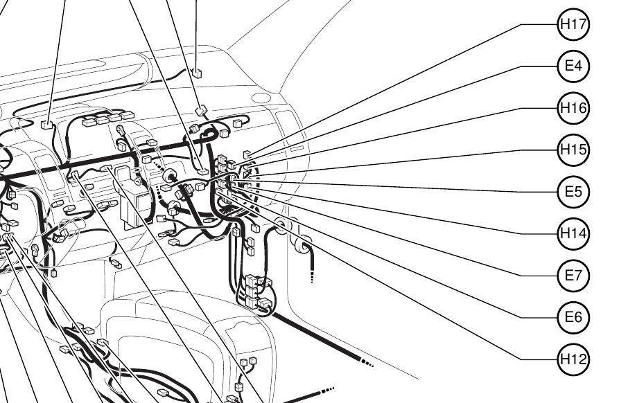

    Here is the location of H12. You need to get into a tight place to see it.
