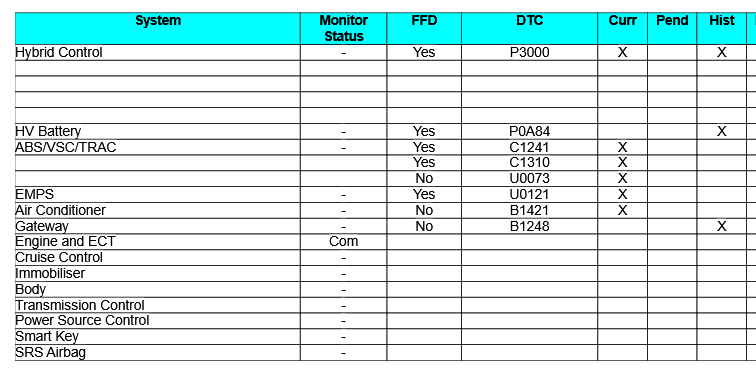

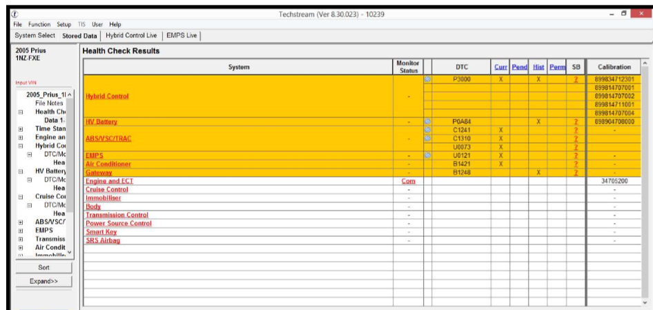

    I think I found the historical list of codes and pasted them below. I am still learning my way around techstream and may have missed some other important reports. Thanks again for your help.
  9. Patrick Wong
    Patrick Wong DIY Enthusiast
    Mar 8, 2008
    18,210
    6,526
    Green Valley, AZ
    DTC P3000 is logged by the hybrid vehicle ECU and means that the traction battery ECU has a problem. For example, did you disturb the traction battery interlock switch when you were working on removing the rear shock on the left side? The switch has a handle that pivots 90 degrees, then it must be slid down to lock in place.
    DTC P0A84 is logged by the traction battery ECU and means that the traction battery fan has a problem. For example, did you disturb the wiring harness leading to the traction battery fan when you were working on removing the rear shock on the right side?
    DTC C1241 is logged by the skid control ECU and means that the 12V bus voltage is low. What is your process to charge the 12V battery?
    DTC C1310 is also logged by the skid control ECU and means that ECU is aware the hybrid control system has a problem, which results in VSC not functioning.

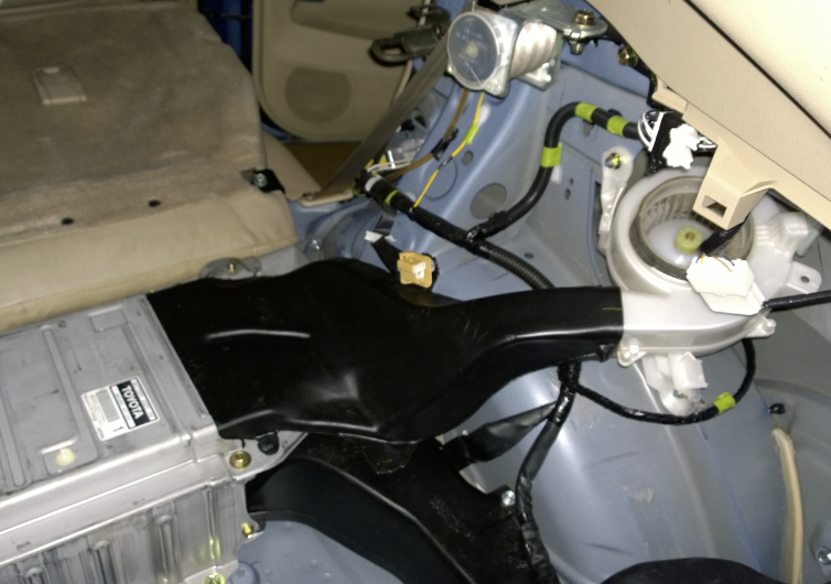

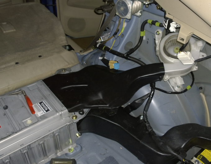

    Patrick was right when several days ago he suggested I may have disturbed some electrical component while installing the rear struts. It turns out I had knocked the battery fan relay out of its socket near the battery fan.
    I had never disassembled the rear interior before so I did not remember what the wiring looked like back there. I was working through a detailed diagnostic for the battery fan and looked at the wiring diagram on TIS and saw that the battery fan relay was in the back to I started looking for it and finally noticed the empty socket and found the relay under one of the battery blower ducts. I must have jerked the relay out of the socket while pulling those ducts to do the strut replacement.
    Earlier I thought I had tested the battery blower relay while checking the fan 2 relay in the engine compartment fuse box, but that was the wrong relay. I need to plan my work better so I am not rushing and so I will not make a make a mistake like this in the future.
    What's missing in the pic above?
    The blue relay in the middle is the battery fan blower relay that I accidentally knocked out of the socket.
    Thanks again for all the help you gave me.
