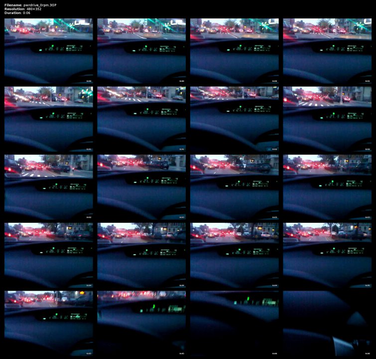

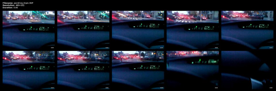

    Not sure how to demonstrate this convincingly short of a video... I almost exclusively drive alone. And if my wife drives there is NO such thing as glide :) Her foot pushes at least one of the pedal either the throttle or the break :-(
    Try to see if I can snap a picture in such state.. but I am almost always drive in PWR (except cold start).
    So you are saying it FORCES the ICE to stay on.... also as Bob's initial experiment shows warming up faster is not necessary "good" for FE at least.

    Sources? You have just to push a button in your car, you don't need a source :) And even when i don't turn on Torque Pro, in the 2013 Auris we have the Engine off light in the dashboard!
    I see you have a 2012 Prius, so you should have my same software. Anyway, beeing a moderator on a Toyota hybrid forum, as per my signature, i know this feature is present also in 2009-10 EU Prius.
    But i'm sure you're beeing sincere saying that, in your car, PWR does'nt leave the engine on above 35 km/h. On our EU cars its like this in any condition, its just a standard feature regardless : that means that your side of the pond, Toyota choosed different settings for PWR. EU cars have it, since 2009.[/quote]
    Hi Maxwell,
    As a follow up... so you can take it as confirmed.
    I took a camera shot of running in PWR mode (fully warmed up) at about 28-29mph and you can see EV light on and the mpg shows full bar. I swear the scangauge was showing 0 RPM. I can not upload mp4 here ... but here is a galery created from the video .. hope this is convincing ....

    I tried the same with EU 2009 (2010 model year) Prius and I can confirm what Maxwell says. Engine will spin and use fuel under 74 kph (indicated), over that speed it's spinned by MG1. This was around 50°-60° coolant temp.
    Maxwell61 likes this.

    Hello Szgabor, i did'nt doubted of your statement about USA HSD :)
    Now you know that EU HSD in PWR mode, regardless of engine & CAT temp, have the ICE spinning above 20 mph. Funny if in Priuschat this feature never appeared....
    But i dont want to derail in OT the magnificent BOB investigation , so i cut it short here.
    If you're interested in the feature of EU PWR mode and the impact of FE or comparison, i'll be happy to talk about in a separate thread.
    I tell you just the relevant bit: unfortunately in PWR EU mode, btw 20 to 42 mph. ICE is spinning but battery usage is unaffected relative to Normal mode, so if the load is light, you'll see the car going on battery alone and ICE turning idling. What you save is just the 0,4% of SOC for every ICE ignition and the relative istantaneous spike in fuel consumption always due to ICE ignition. In my experience, it compensate the fuel burned idling.
