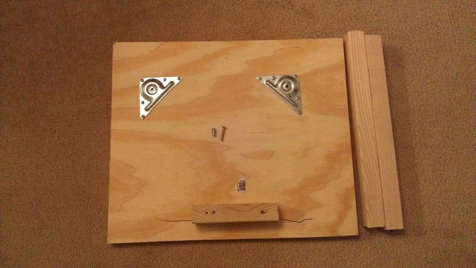

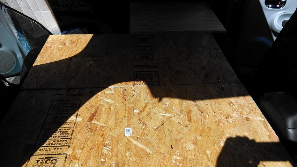

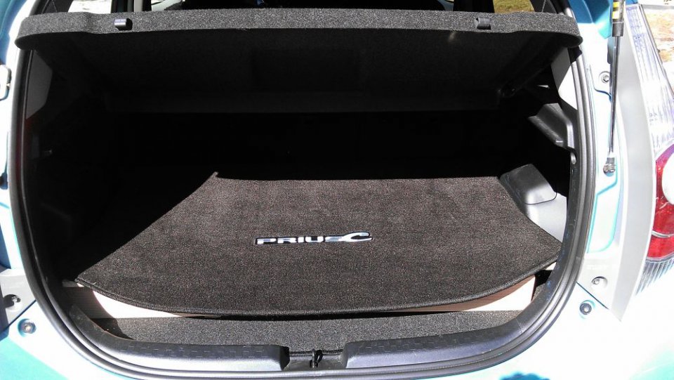

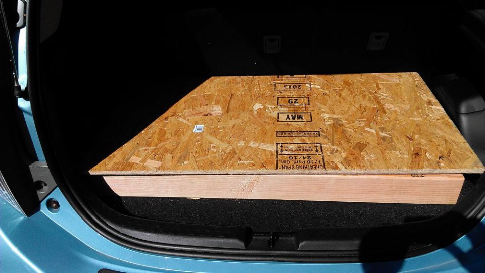

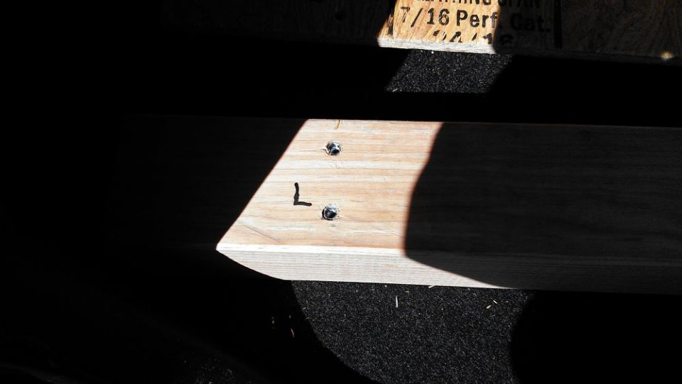

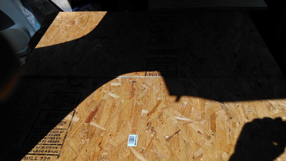

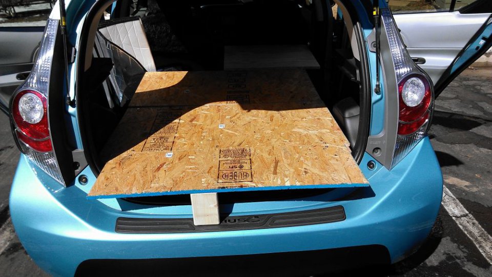

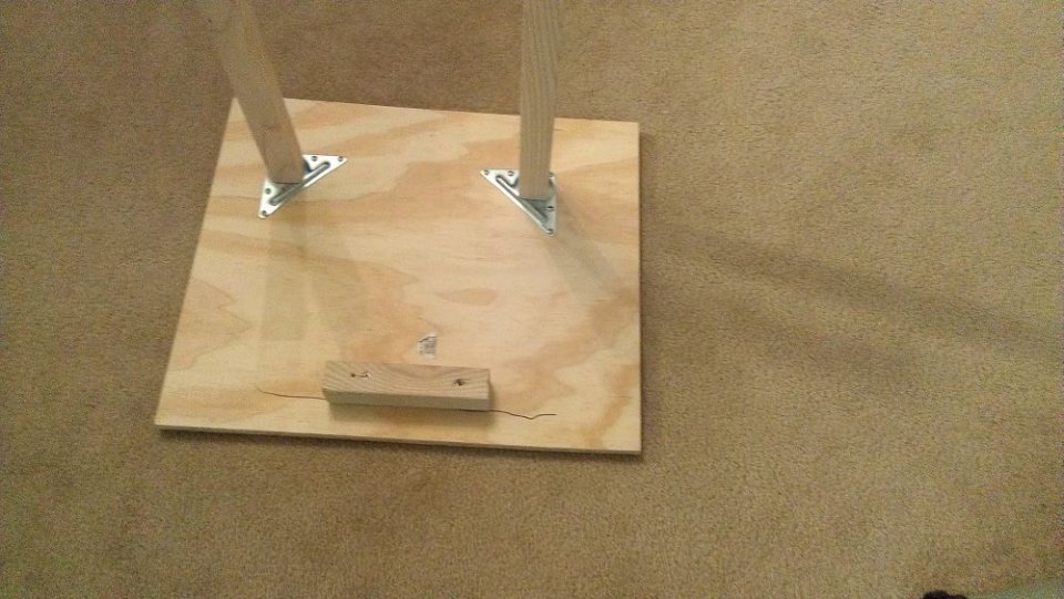

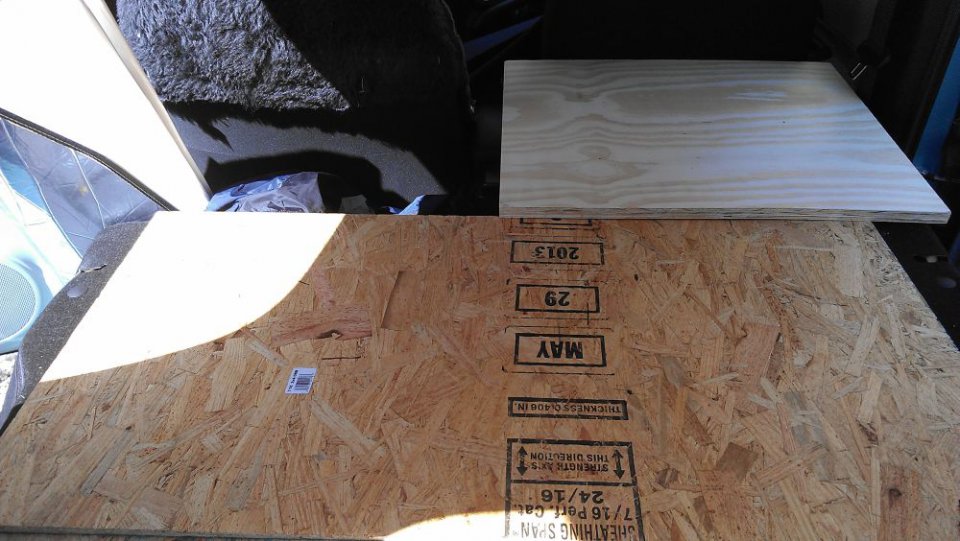

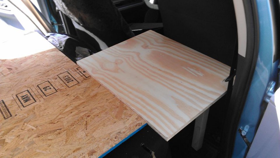

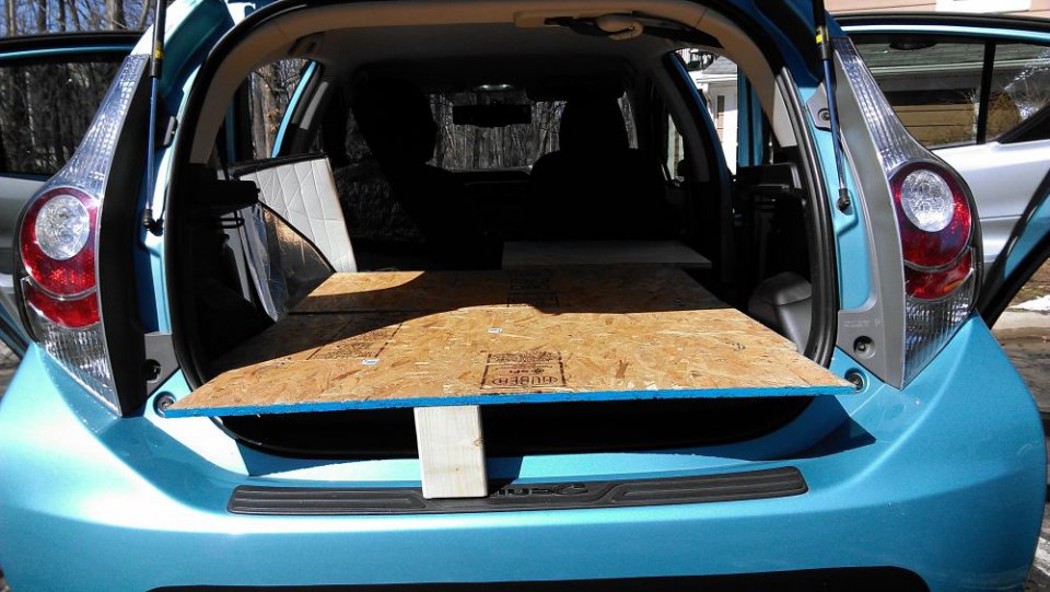

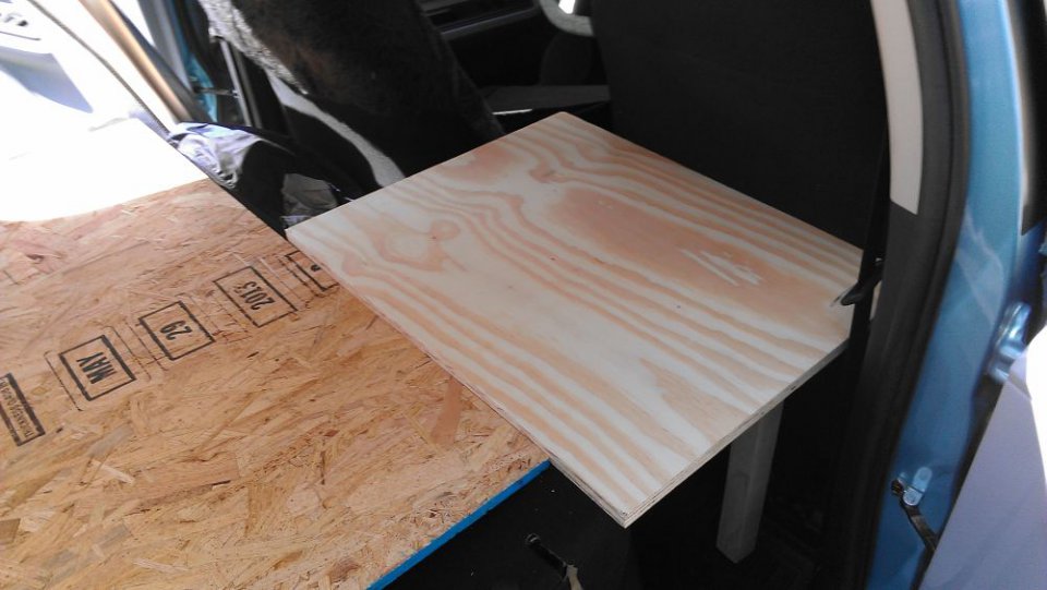

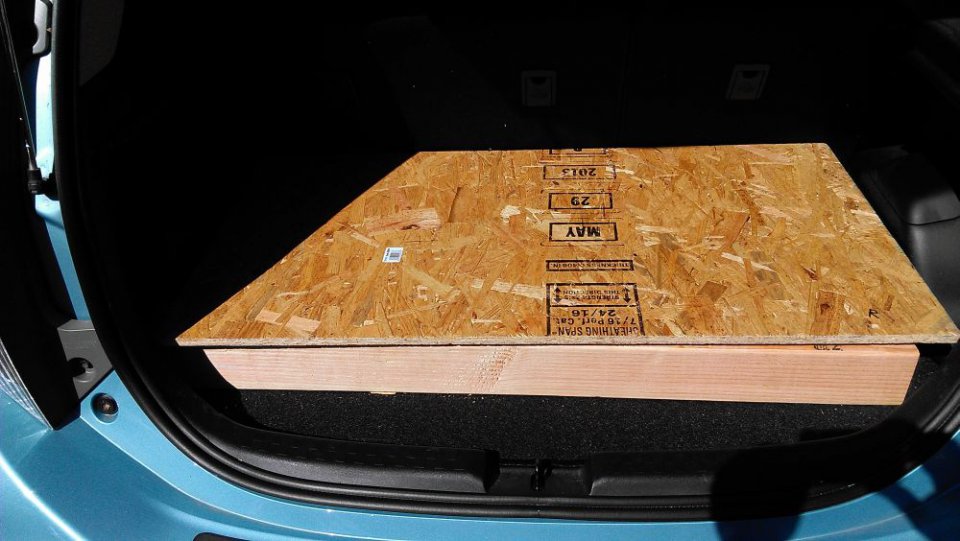

    I have cut 2 .5" plywood into 20x39" sheets and 2 4x4 into 39" lengths and 20x24" plywood with 18" legs added for head support. The 4/4 and plywoodsheets level the back out with the seats folded down and the sheets fit tin the back when the seat is up.

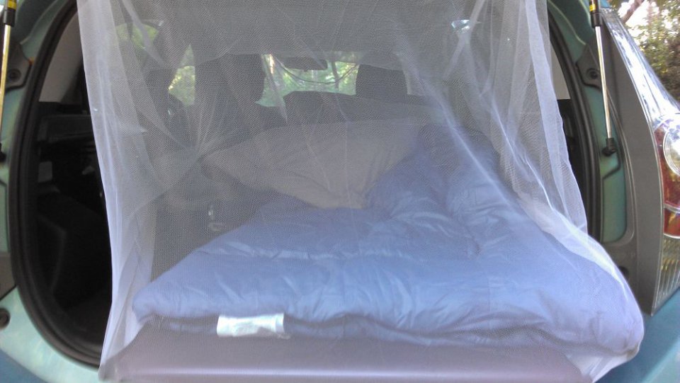

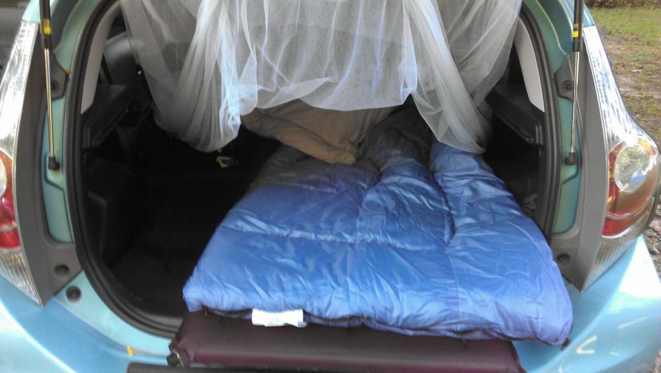

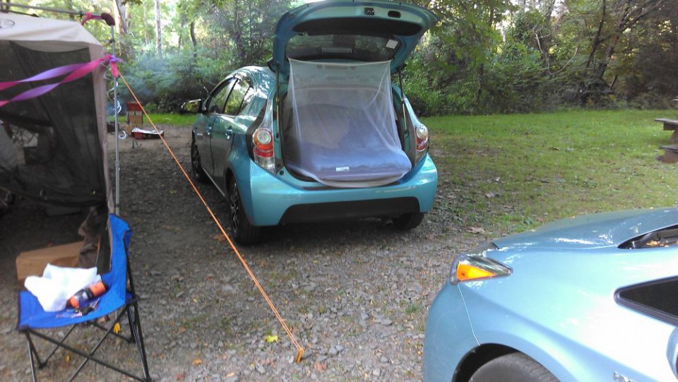

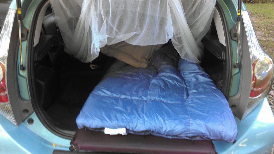

    Here are some picks, I use Mosquito netting instead of screens that is why I have the 12" overhang in the back
    01 C camper  stored.jpg 02 C camper  stored no carpet.jpg 03 C camper  4x4 with screw.jpg 04 C camper  assembled 1.jpg 05 C camper  assembled 2.jpg 06 C camper  assembled 3.jpg 07 C camper  assembled 4.jpg 08 C camper  assembled 5.jpg 09 C camper  assembled 6.jpg 10 C camper head support 1.jpg 11 C camper head support w screws.jpg C Camper1.jpg C Camper3.jpg C Camper5.jpg

    Wow, thank you for all the photos! You really made quite a sleeping environment. I am very impressed!

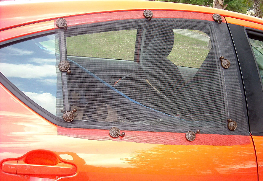

    You can see my simple screens of fiberglass screen from a hardware store and some magnets.
    I live in my car, and need to store all of my belongings in there with me, so I will not be able to copy your idea, but I may try to use some of your design concepts for myself.
