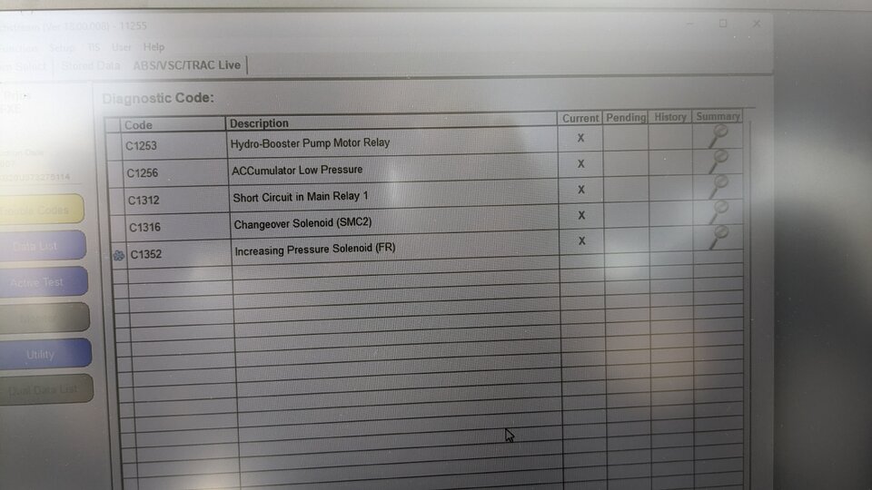

    Hey all,
    So I finally got a new, albeit used from eBay, ABS module in my 2007 Prius. Doing it myself since mechanic who said I need a new one told me it was $3500 job. Brakes had gone out completely.

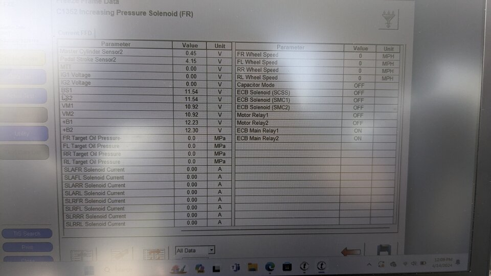

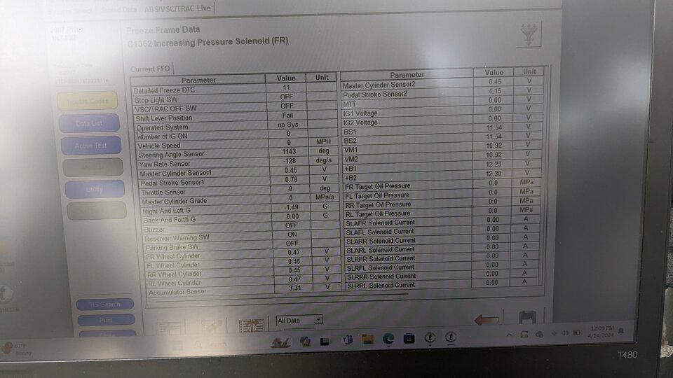

    Problem is, I still have brake, ABS, the left exclamation point, and the V-something dash lights on. Brakes are squeaky and soon after starting to drive a buzzing sound comes on and the brakes stop working. I let the car sit for a couple minutes and they work again for a little until they go out again. Attached are Techstream codes.
    Now that I got ABS replaced, I bleed the brakes manually in case that was the cause and also because I hear I should after ABS replacement. I am not sure I did it fully, but seemed a steady flow. I have little mechanical experience.
    I did try and bleed my brakes with techstream, but whenever I started the brake bleeding process it would fail, due to either low voltage or unmet conditions. I did remove the ABS relays like it said. Perhaps I am unsure what ignition mode is, or perhaps my battery is low from sitting. Regardless, I then did it manually.
    Not sure what to do from here. I believe the new part is working since my brakes work for a little before going off, and also I think I hear it running. Any ideas?

    I don't think you're bled correctly or your new assembly is not good You're accumulator pressure should still not be low but it can be if you're not bleeding correctly there's probably air still in the system but letting it sit isn't hurting anything You need to get your battery on a charger the 12 volt and make sure you can make it through the whole process It's not very lengthy and it doesn't take a whole lot of power but I guess some people linger through the process once you do it once or twice or three times You should have it pretty well down pat
