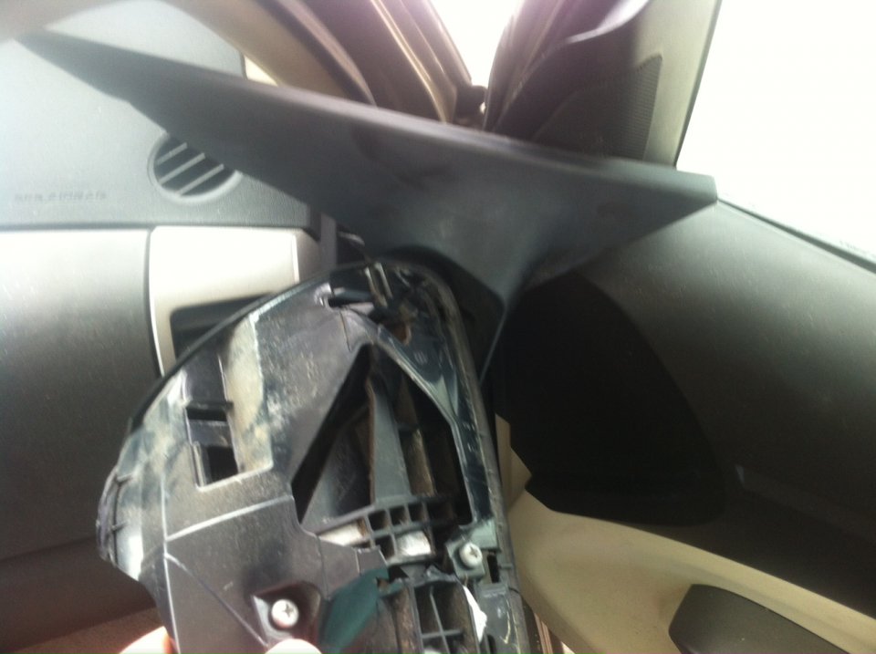

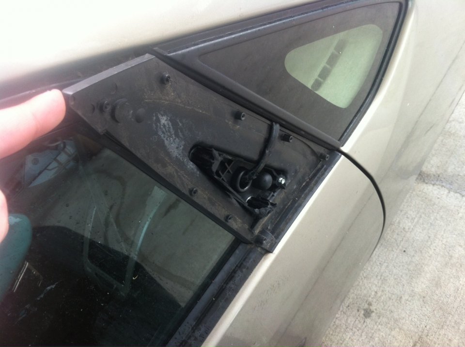

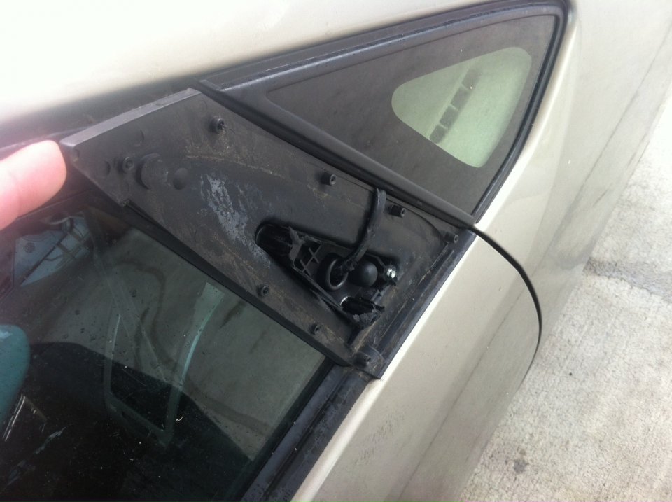

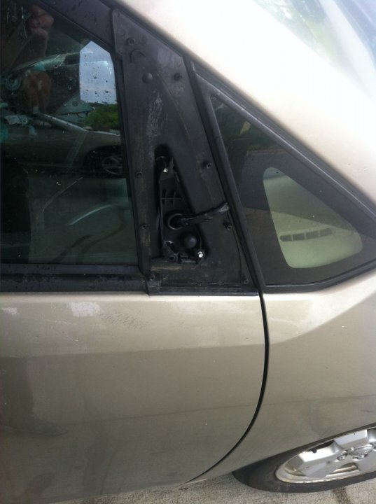

    I spoke with Steve and unfortunately they do not have any mirrors in stock at his facility, thanks for the advice though. I also cant seem to find any with the driftwood pearl color available, I am going to continue looking but will purchase a black one this evening if necessary. Below are pictures of the mirror damage, i currently have it hanging inside the door because I am unsure if the wire can be cut. please take a look below, the inner rubber lining (that I have my finger on) is no longer attached but I figured that can be glued if necessary. Do you see anything that makes it look like the installation cannot be done with whatever mirror I purchase online?

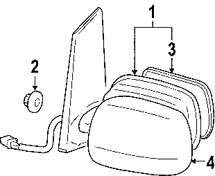

    It can be glued but glue won't likely last long in weather. It is best to fix it the "right" way. I don't really know how it comes apart without seeing it in person but, what I would do is take it completely apart and determine what exactly broke. If gluing is necessary, I would use high strength waterproof epoxy then clamp for 2-3 hours. Everything can be fixed and a new mirror can be mounted, its just a matter of determining what parts you need. You may just need a mirror or you may need some other parts as well. If you go to an online parts dealer, they will likely have a diagram of it.
    Check here. OEM 2005 Toyota Prius Replacement Parts - Olathe Toyota Parts Center
    And btw, don't cut the cable until you get the new mirror. You shouldn't have to cut the cable anyway. You should be able to unplug it.
    Here's what the diagram looks like (not too detailed)

    8,647
    That mirror is broken beyond repair......the vibrations from driving would make any repair temporary before falling apart.

    JC, why do you say broken beyond repair? I am about to buy a replacement mirror online and install, is that not going to be possible?

    You can buy a replacement, that would be the correct way to fix it once and for all....I was referring to gluing the thing back. Looking at where it broke off, any attempt to glue would be temporary.......and you would have to address it again later.

    It looks like the new mirrors come with all the parts you need.

    Yes the replacement mirrors comes with everything. I had to replace my driver's side once. Very easy job, I think 2 or 3 bolts that hold it in place and plug all the wires into a harness. You do have to remove the door panel to get access to the harness.
