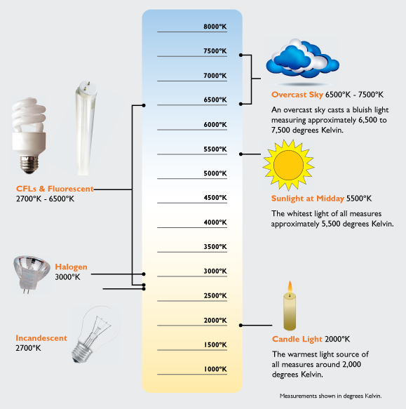

    1. what you are used to / what you grew up with, yep I believe I mentioned that above.
    2. You saw bad lighting labeled 4100k? Maybe because
    a. it was because of 1.
    b. it was truly bad lighting (low CRI or mislabeled as 4100K when it was really 7000K or some other issue)
    either you just need time to get used to good lighting or you don't understand how yellow 2700K is.
    While different sites reference pure white at differing K values I think the image below is a good enough to get the point across on how far down the scale your 2700/3000K bulbs are.

    Interesting discussion, Dhanson.
    I also find myself thinking of fluorescent as whitish-blue, but perhaps I am blinded by preconception, or other aspects of light that play into the question.
    Found this related to natural sunlight:
    Before sunrise: 10,000 degrees K
    Before sunrise the only illumination comes indirectly from a blue sky. This produces a characteristic strong steel blue color.
    Dawn: 2,000-2,500 degrees K
    The lighting will change to a very warm red color just as the sun comes up. Look for the first appearance of shadows.
    Early morning: 3,000-4,000 degrees K
    The color temperature will become more neutral as the sun continues to rise through the morning.
    Midday: 5,500 degrees K
    Overhead sun at noon produces neutral colors, though this may not be best pictorially.
    Overcast: 7,500 degrees K
    Overcast lighting conditions raise the color temperature noticeably. Your photographs will have much cooler colors.
    Shade: 10,000 degrees K
    The color temperature in shade on a sunny day is extremely high. All of the lighting will be coming from the blue sky.
    Afternoon sun: 3,000-4,000 degrees K
    The color temperature will fall as the sun goes down. The light effects become warmer and redder.
    Sunset: 2,000-2,500 degrees K
    Some of the reddest lighting conditions of the whole day will be at sunset.
    Twilight: 10,000 degrees K
    Just after sunset, the lighting will suddenly becoming very blue, for the same reasons as the shadows above.
