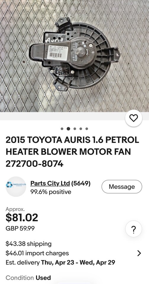

    Given you are in Australia, there is a good chance your blower is different than ours based on "the old motor [number] is 272700-8074."
    That number is known as a housing number and is not the part number. However the housing number for a US Prius v is different which means our part number is also different.
    Some used sellers think the housing number is the part number and therefore a buyer can sometimes find that number on ebay. I found your part on ebay in the UK and other locations outside of the US.

    I found a few on ebay in Europe including the UK. Again this is not the part number.
    The shipping and import charges are for a US address due to our current trade war. Your charges may be far less.

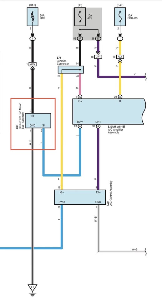

    This blower has electronics in it to take a pulse train from the AC Amplifier ecu as control for the blower's variable speed power electronics.
    From a wiring standpoint it is simple:
    Constant power, ground and a signal line.
    Finally, I would make sure the newer blower wheel has the same fin orientation as the original.

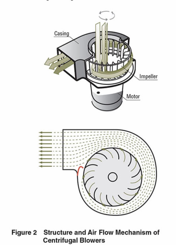

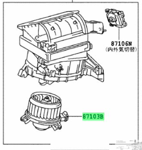

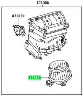

    The shape of the blower box and the position of the outlet do, though, do they not? Given that the outlet is offset to the front of the box, one direction would seem to be the correct one, yes?
    On the RHD, the blower assembly is fixed to the LHS of the air conditioner radiator assembly; conversely,
    On the LHD, the blower assembly is fixed to the RHS of the air conditioner radiator assembly.
    RHD ---------------------------------- LHD
    The above illustrations would suggest that the fan would rotate in one direction for the RHD, and for the LHD, it would rotate in the opposite direction. I'm no expert on these things, and happy to be wrong about the specifics, but my pick would be that the RHD would rotate clockwise (looking down from above) and the fan's fins (across the front) would be curved to the right. The LHD would rotate anticlockwise, and the fan's fins (across the front) would be curved to the left.
    The illustration posted above by rj is the basic design of the LHD blower. The RHD blower is a mirror image of that.

  9. ChapmanF
    28,653
    18,969
    Even if they have opposite rotation directions, though, the result would be anemic airflow, but not reversed airflow. Even when rotating opposite its preferred direction, a centrifugal blower moves the air in the centrifugal direction. Just less efficiently.

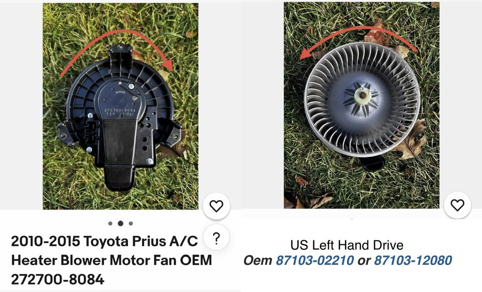

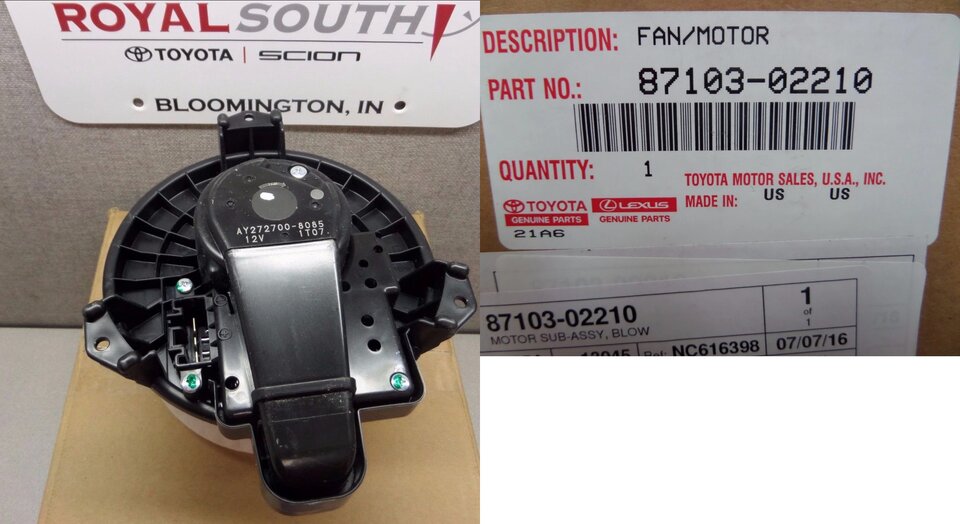

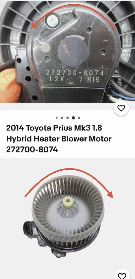

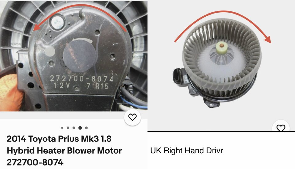

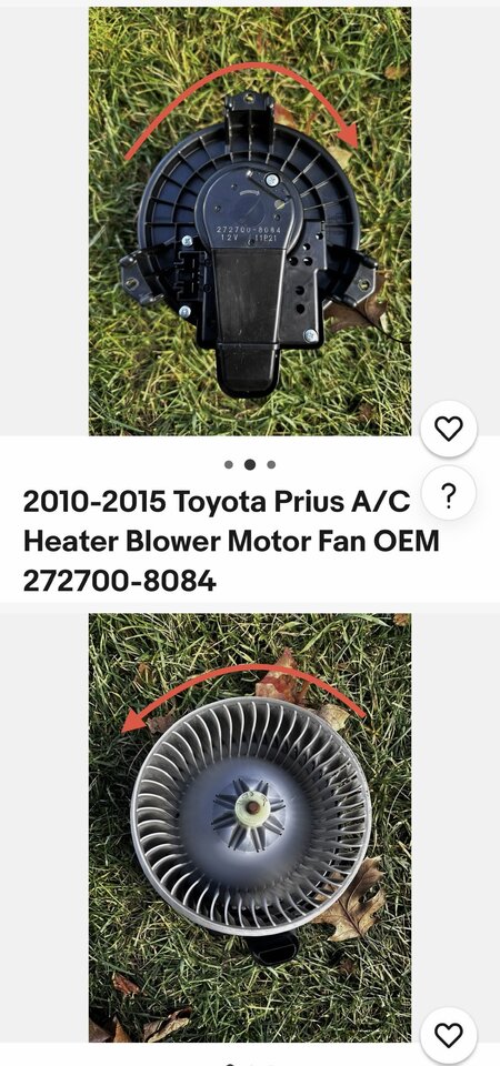

    Regardless, a little more ebay reverse engineering
    US version left hand drive CW from motor, CCW from blower wheel (Factory White Rotation Arrow on left pics)
    So the wrong blower will run in reverse with a wheel built for reversed rotation.
    The enclosure has to be made for the rotation or the blower won't function.
    In the op's case. she needs a US or other left hand drive blower.

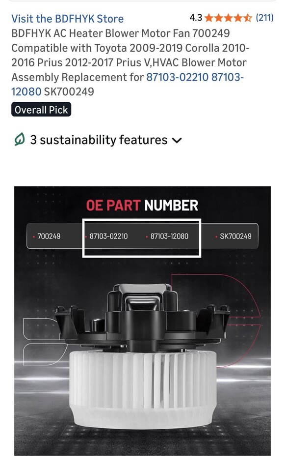

    Aftermarket 700249 or SK700249 (~$50)
    #11 rjparker, Apr 15, 2026
