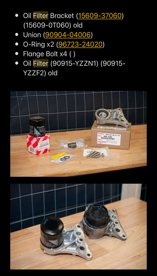

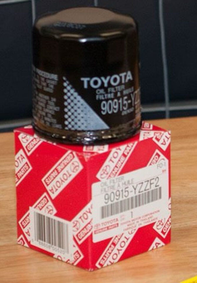

    I would leave the filter in for the next 5k miles. Toyota filters are good for 10k easy. The 5k oil change is the key thing on a gen3 with its extra blowby due to the low tension rings. The oil dilution is not filtered by any filter, new or 10k old.
    Those plastic filter housings are routinely too tight - some have changed the assembly to a more conventional one piece filter. Pretty easy from the passenger's wheel well.
    If you are dying to get under the car, change the engine coolant. That may save you big money down the road.
