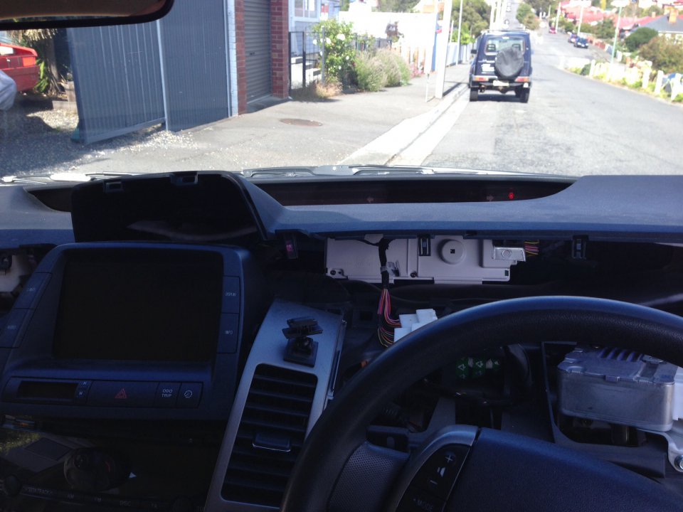

    I did it! And I now have the perfect car... This isn't a software mod, that doesn't work in Australia or Europe apparently. You'll have to actually pull apart the dash but it's really easy, I t took me 1hr total.
    First step is to pull the dash apart. It is been better explained elsewhere, so google ingineerix cmremoval

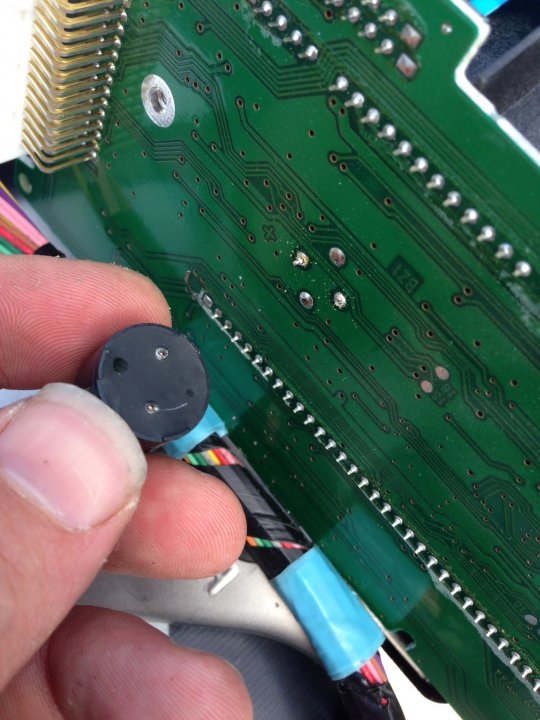

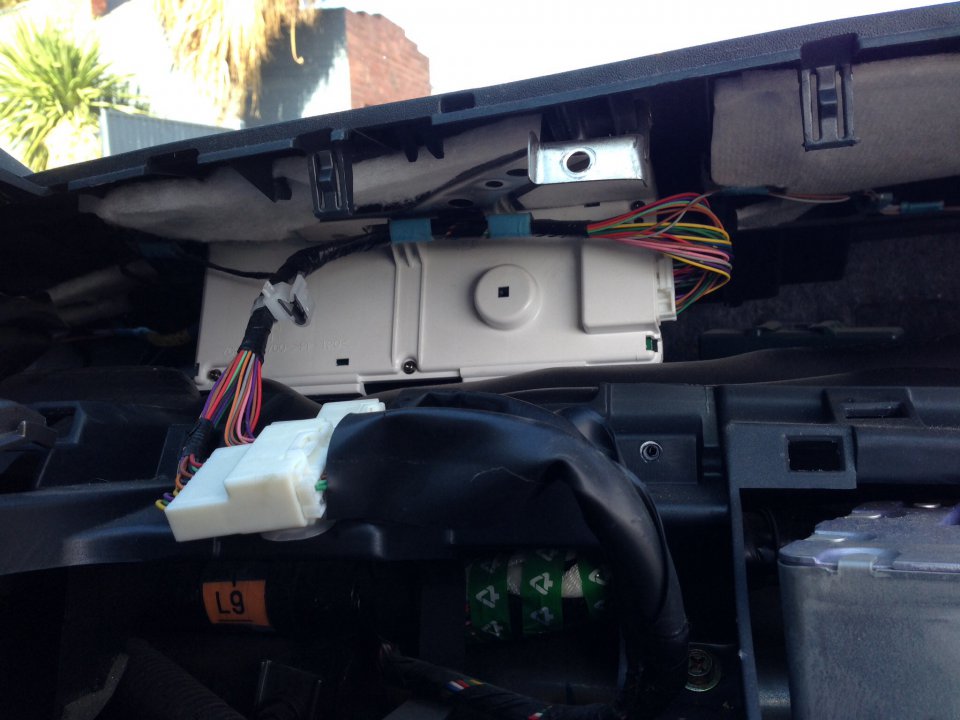

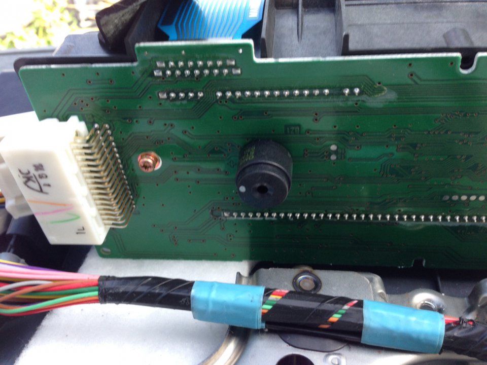

    Once you've pulled the largest bit of plastic, the dash itself, you'll find the instrument cluster is attached to it underneath. This is where that little speaker is that's the cause of so much distress. You can either get a drill and drill out the speaker through the little square hole in protective plastic cover being careful not to drill too far into the circuit board, which is what I would have done in hindsight. Or you can do what I did and pull the plastic cover and wiggle the speaker back and forth until it snaps off. I recommend the former option, solely because I imagine the violence would be more satisfying :)
    No beeps occur, no errors occur, everything is perfect! The beeps you'll 'disable' are 1) reverse 2) seat belt 3) door open with keys in the ignition 4) attempting to engage 'b' mode from neutral
