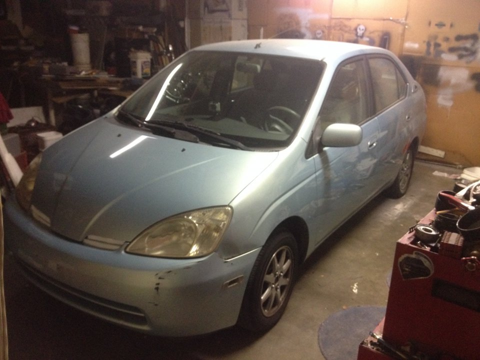

    I recently purchased a 2001 Prius, that was dead. Had to replace the Aux. battery, and rebuild the HV battery pack, to get it going again.
    The initial error was the red triangle of death, and the code was P3030, High Voltage short. I disassembled the pack, and found ten dead cells, and several under 7 volts. I found a guy selling Gen 2 cells, at a bargain price. So then I replaced all 38 cells from newer totaled Priuses.
    I checked them all individually, which they all where above 7.5 volts. I felt nervous about connecting them all together to balance them.
    So then I just put them back into the Battery Tray, got most of them bolted in place, threw it in the car, and it started right up, with 60% charge reading on the battery. Let it run for a few minutes, and it came up to 80%. I drove it around, and it was getting 48 MPG, and the Battery never went below 80%. It seems to like the new Gen 2 cells. I am so excited to be driving a Prius, even if it is a 2001, I am loving it!!!
