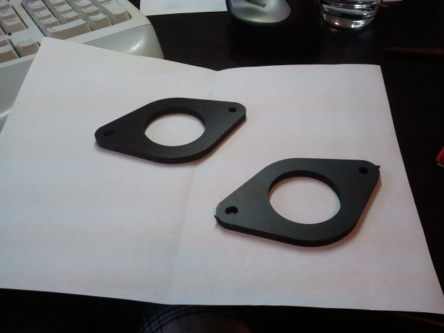

    So after reading about how bullet proof and superb their adaptors were, I bit the bullet and bought two front door adaptors (at $26 for the pair) and two tweeter plate adaptors for the dash (see pictures).

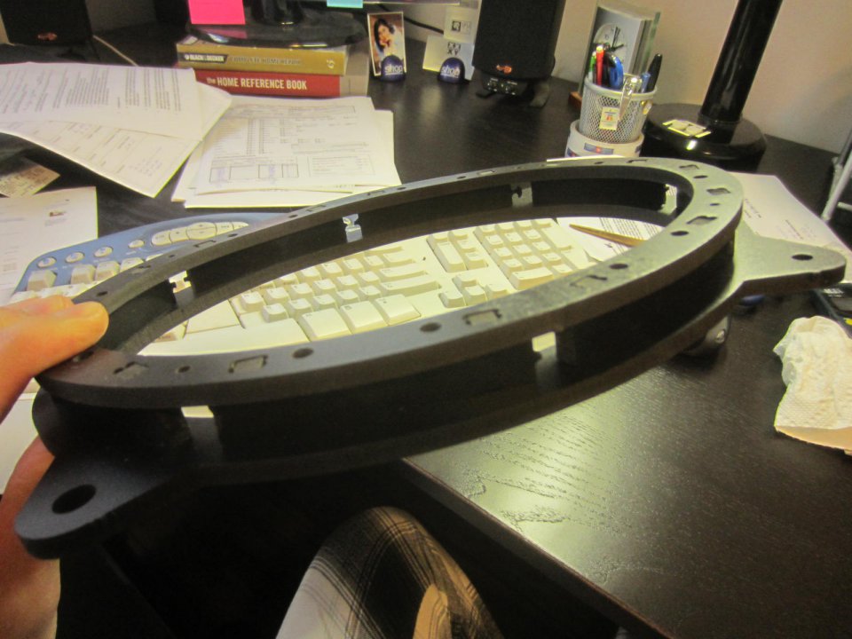

    I received the adaptors by mail and I have to give credit to this business. The PVC plastic is thick + sturdy and the 6 x 9 adaptor does not laterally flex when you try and twist it. However, that is where the good news ends.
    Problems:
    First of all, Mike who I presume is the owner of this business sent me the wrong 6 x 9 adaptor. I double checked my receipt to make sure it wasn't a problem on my end as I could have ordered the wrong set. The part number is confirmed and I did indeed order the 6x9 to 6.5 inch conversion adaptor. However, the business sent me the 6x9 --> 6x9 adaptor which is useless to me since I have a set of JL Audio C3-650's for the front.

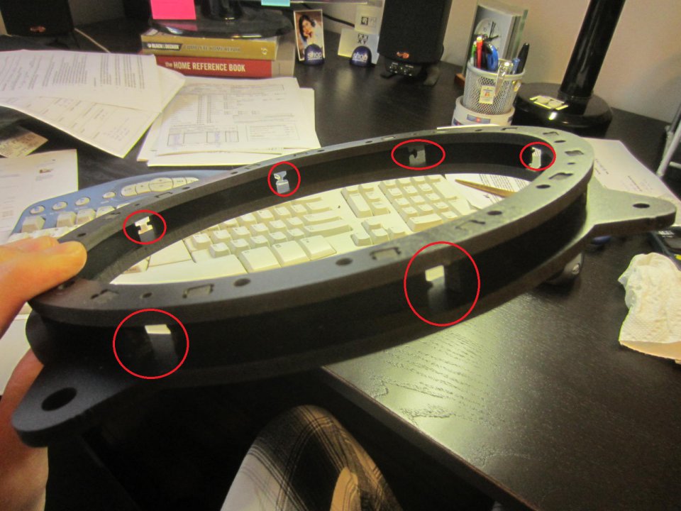

    Second thing, and this might be a major problem is that I noticed that the adaptor design itself may be flawed! The spacer on it has gaps everywhere letting air to escape if one mounts a speaker to it (see my picture with the red highlighted circles on it.). I can't claim I am an experienced installer or car audio guru but to the best of my knowledge, a midrange driver or woofer needs some sort of airtight enclosure to work. Although a car door is probably far from being airtight, these gaps on this speaker adaptor won't create a decent enough air seal for the midrange to work effectively. I'm guessing the bass would be really shoddy since there is no back pressure generated since the gaps on the adaptor don't allow for an airtight seal. Might as well have the speaker work in "open air."

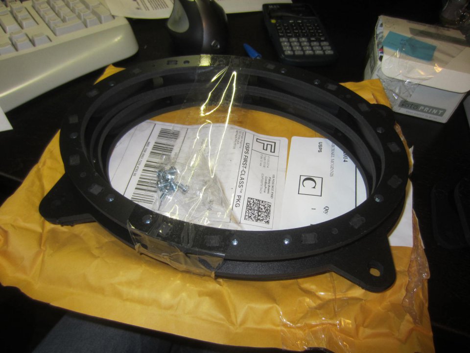

    One last gripe I had was that the adaptors arrived in a cushioned package but were taped to each other with transparent tape. After taking this tape off, there was very sticky residue left behind on the adaptors by the tape's adhesive. The glue took a while to come off and I had to use solvent for the removal. Small problem but still something that a customer shouldn't have to deal with.

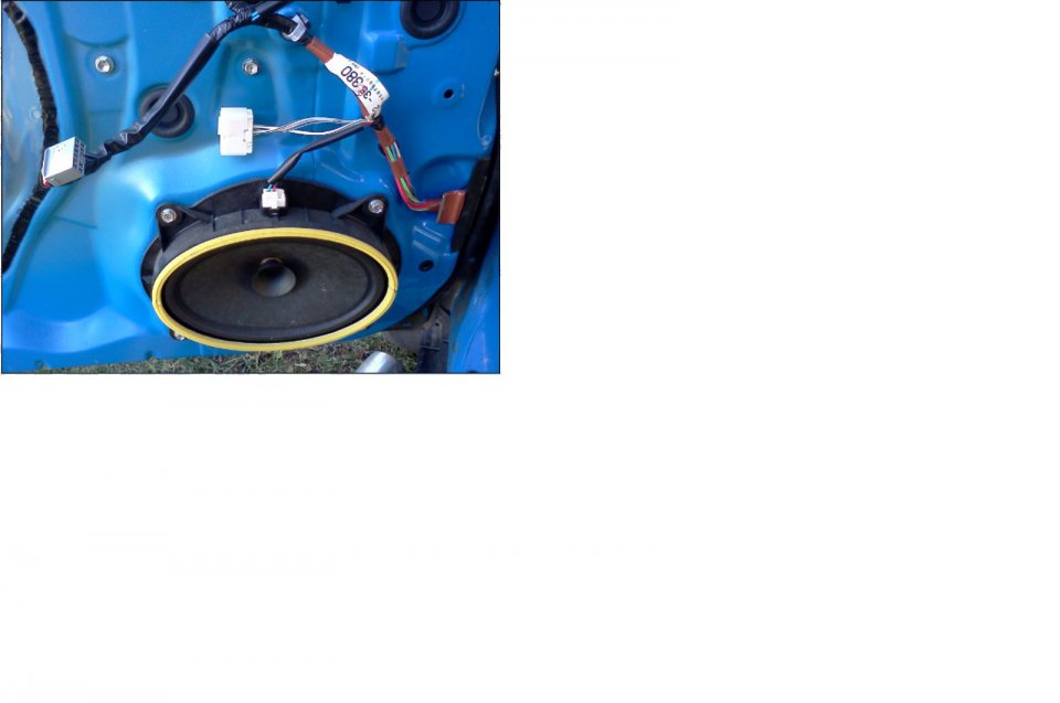

    Attached are pictures. The picture with the blue door is what an oem adaptor should be - no holes or gaps in the unit allowing for a decent airtight seal. The rest are pictures of the adaptors that I purchased which I suspect are bogus. The tweeter plates appear to be fine.

    The holes you circle do look quite odd, and should be filled with something to make them airtight, or at least more airtight. It looks like they are an exact fit for the prius, though clearly not for your 6" round speakers.

    I think the makers of your adapters should send you the ones you ordered. If they have the odd vents in the middle, I would fill them up with silicone or tape or something.

    I have to admit, the ones I received look and feel quite bulletproof. Too bad the company that makes them doesn't seem to have much knowledge about how a speaker and enclosure should work. The holes are 1/2 inch by 1/2 squares so I can't fill them in with silicone.

    i hate when companies put sticky stuff on thier products. tape, labels, whatever. some use products that remove easily and leave no residue, that's the way to go.
