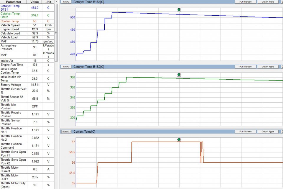

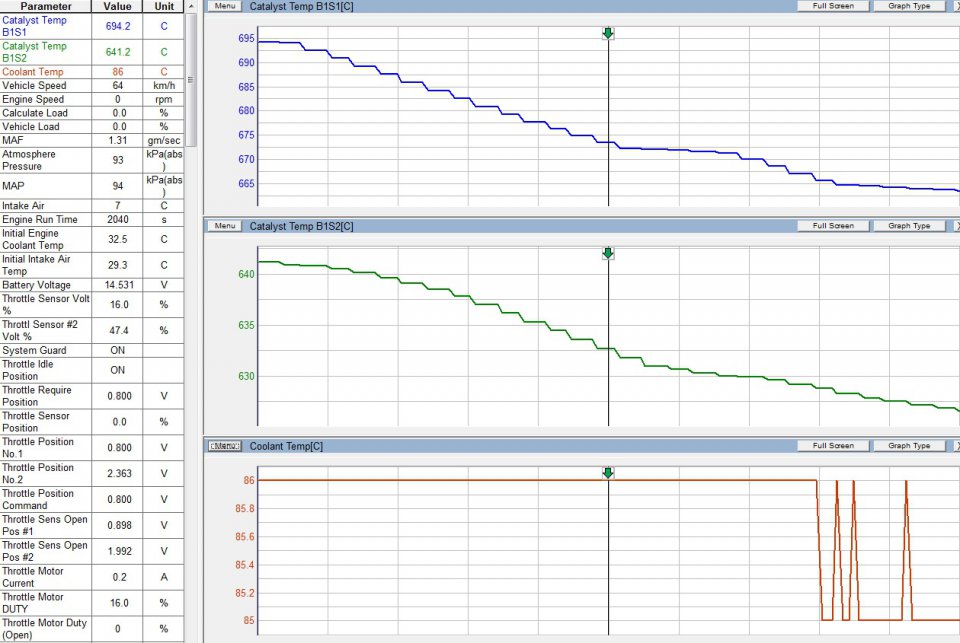

    I have the log files that were recorded from Paja's Gen III and B1S2 is always lower than B1S1:
    Vincent

    Vincent,
    Those graphs are very similar to what I am seeing.
    Thanks for posting.
    Dwight
