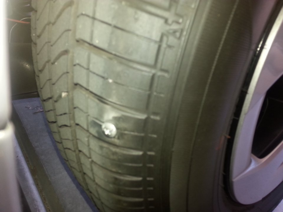

    i noticed this AM that a screw was embedded on my left rear tire, so i took it out . TPMS still not appearing on the dashboard.. if its leaking, how long can i still drive it for? i believe if your tire pressure is low TPMS will alarm but wont tell you how low it is right?

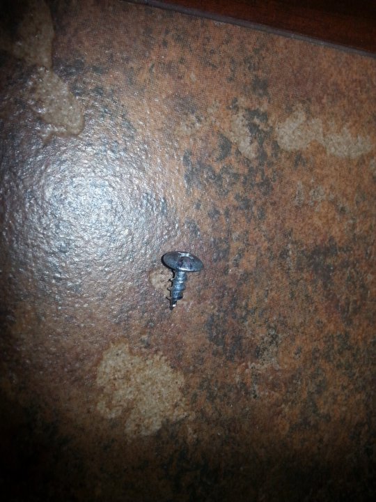

    Attached was the screw embedded on the tire. So far its running ok

    Looks just like the screws that come with those plastic lifetime sheds Costco/BJs wholesale clubs sell.

    That looks like it might have been very close to poking all the way through.
    I would be a bit nervous, especially since it is over near the sidewall.

    Maybe mark the inside of the rim near where it was, then keep any eye on that tire, monitor pressure frequently.
    I've found one of our OEM's had a sort of cylindrical "bite" out of it, sort of like some sort of bolt was there, for a while, then flung off. It goes alarmingly deep. I was even contemplating doing a pre-emptive plug repair, having a kit and having done a couple of other repairs. But I can't bring myself to punch through a hole that's not leaking as yet. That was about a year back I noticed it, and so far all good.

    No, this is too short to go through the tread in a brand new tire. Lucky, as this spot on a shoulder is considered not reparable by most tire shops.

    Ahh,, its just a little Screw, not a big one. You did the right thing by soaping it down, watching for bubbles, and listing for the dreaded Hisssss. :eek:
    Not to worry,, everyone gets "a little screwed" now n then!o_O
