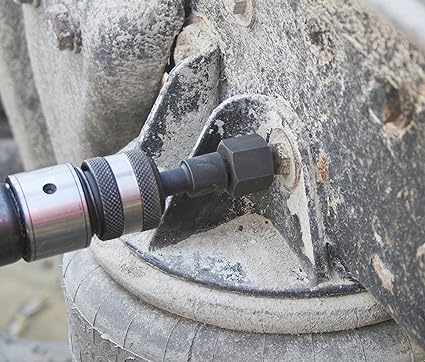

    If there are any left, slide under the car and spray their exposed ends with some PB B'laster or other penetrating oil, then come back for them tomorrow.
    Using a regular impact wrench (the kind that uses hard knocks to turn the socket) is risky, as you've seen, with small seized fasteners, as it may just twist the heads right off.
    A kind of tool more to the purpose is this sort of thing:
    That's an air hammer it's chucked into, not an air wrench. You use your own open-end wrench on the outside hex to keep up a steady lefty-loosey force, while the air hammer's job is to just keep bopping away straight on the head of the bolt to shake the threads loose. That way there's nothing putting an excessive torque on the head to risk twisting it off.
