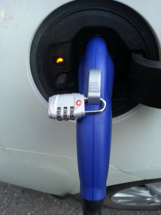

    A small luggage combination lock with a fairly long shank was my choice, and it works perfectly.

    If anyone seriously wants my charging cable badly enough to break the lock, they can have it. Last Friday night, I watched out the window of my hotel, while a kid walked by my car and shook the charging cable as he went by. If I hadn't locked it, there's a chance he might have snitched it.

    The thing is that when it's locked, you never know how many times the lock saved it from being stolen. If you leave it unlocked and it never gets stolen, that doesn't mean it won't get stolen the next day.
    I call it "peace of mind" to lock it.
