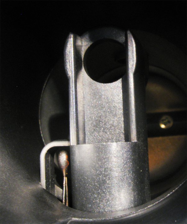

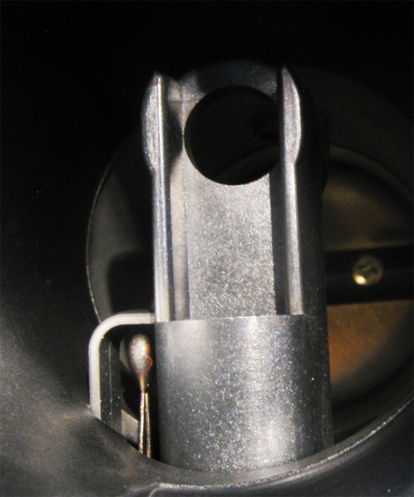

    I checked the pitch on the driveway and used some old 4x4 ramps and a few scraps to get the car dead level. The oil on the dipstick is now right on the mark.
    For the record, I calculated the forward pitch at ~1"/foot or` 9" for the ~9' wheelbase. I make that 1/8" inch on the dipstick for every 3" down-pitch along the wheelbase.
    While I had the hood open, I popped the air cleaner. It was 'nice and clean' inside. I noticed that I could look straight down into the MAF. The 'amber bulb' looks pretty dirty (kind of a dull, metallic grey) to me. I uploaded a digital photo.
    Perhaps this is the culprit?

    Yes, it might be. You could start by buying a can of MAF sensor cleaner, removing the sensor and spraying the bulb and the sensor wires to clean them off.
