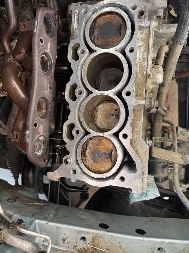

    Typical Gen 3 head gasket failure. Coolant leaks past the head gasket into cylinder #1 or #2. This causes misfires on cold startup of the engine. Check the engine coolant level in the plastic reservoir.
    I am amazed that the engine made it to 270k miles without a head gasket failure earlier.
    Do a search on this forum. You will find hundreds of threads that discuss the head gasket failure on the Gen 3 engine.

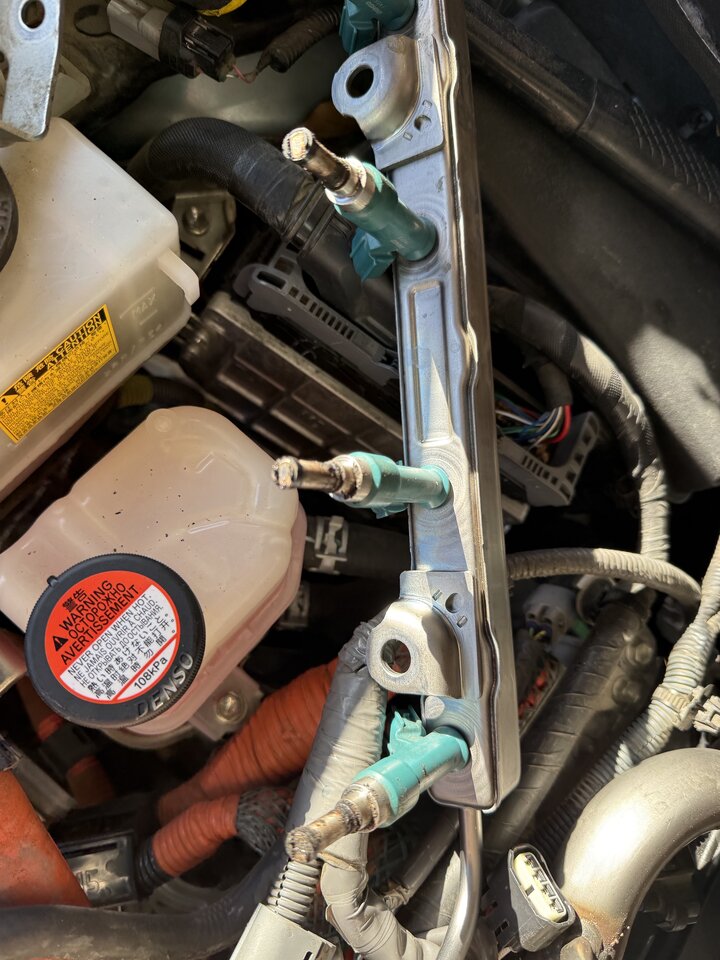

    Coolant loss will be slow at first with occasional violent rattles on startup. Spending money on plugs, coils, injectors or egr cleanings is 98% a waste with this problem.
    A replacement engine is best but if you go with a head gasket repair do it quick before an overheat forces the issue.
