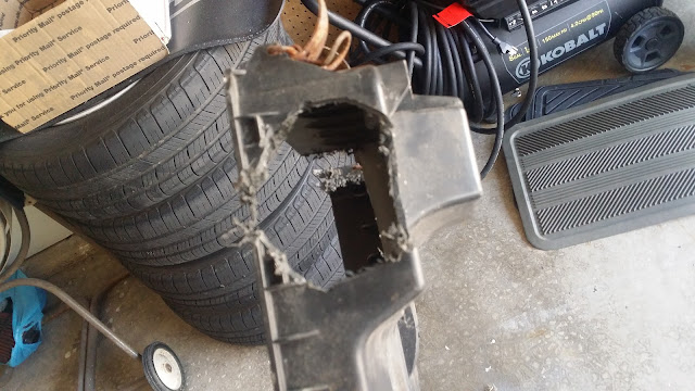

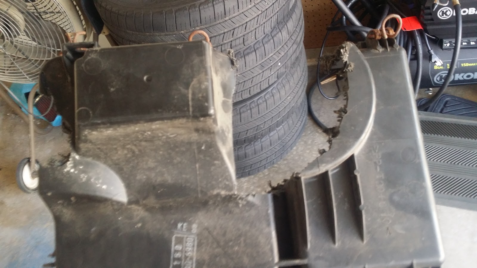

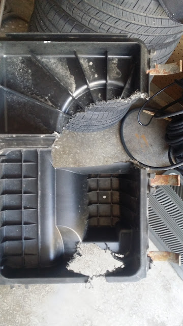

    Was able to snag an extra air box from this Prius at a junk yard.
    First make large cuts to remove the MAF housing and the extra tube that connects to the OEM air hose. The MAF is oddly shaped and would not allow for anything else to clamp onto it. The air intake side part will be used to fix this issue.
    I took a torch the the ends of the MAF and extra part then with a flat head screw driver started molding/pulling the melted plastic. Make sure there are no air holes or leaks. I would heat it ,mold a little then cool it off in water until I got the desired result. Used a dremel inside after wards to smooth out the inside and grinded the outside to get any plastic clumps off.

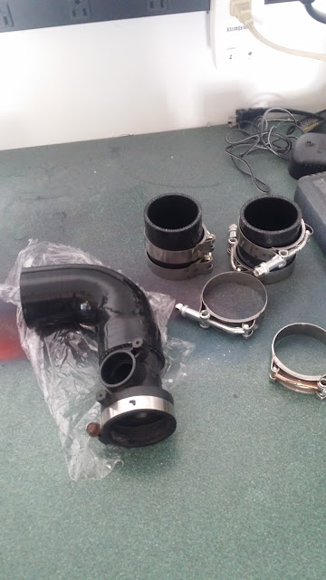

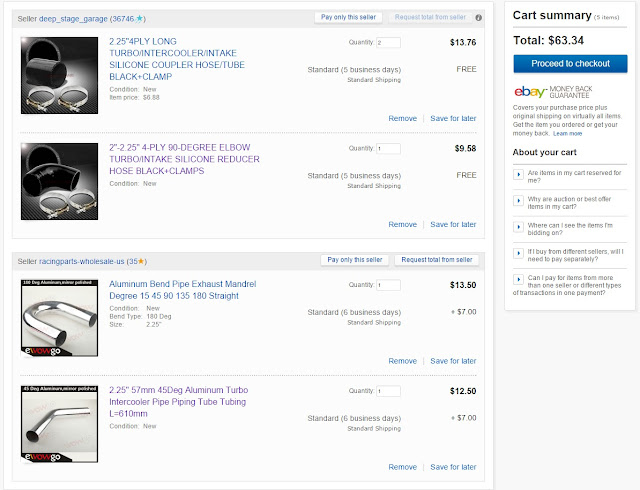

    Some of the parts I ordered. Only thing missing is a small cone air filer.
    First parts to arrive. 2" to 2.25" elbow fits fine.
    Filter came in next. Had to remove the hood insulator for this to fit. Waiting on the tubing to come in. Sounds meaner already.
    Tubes came in so time to try some test fits.
