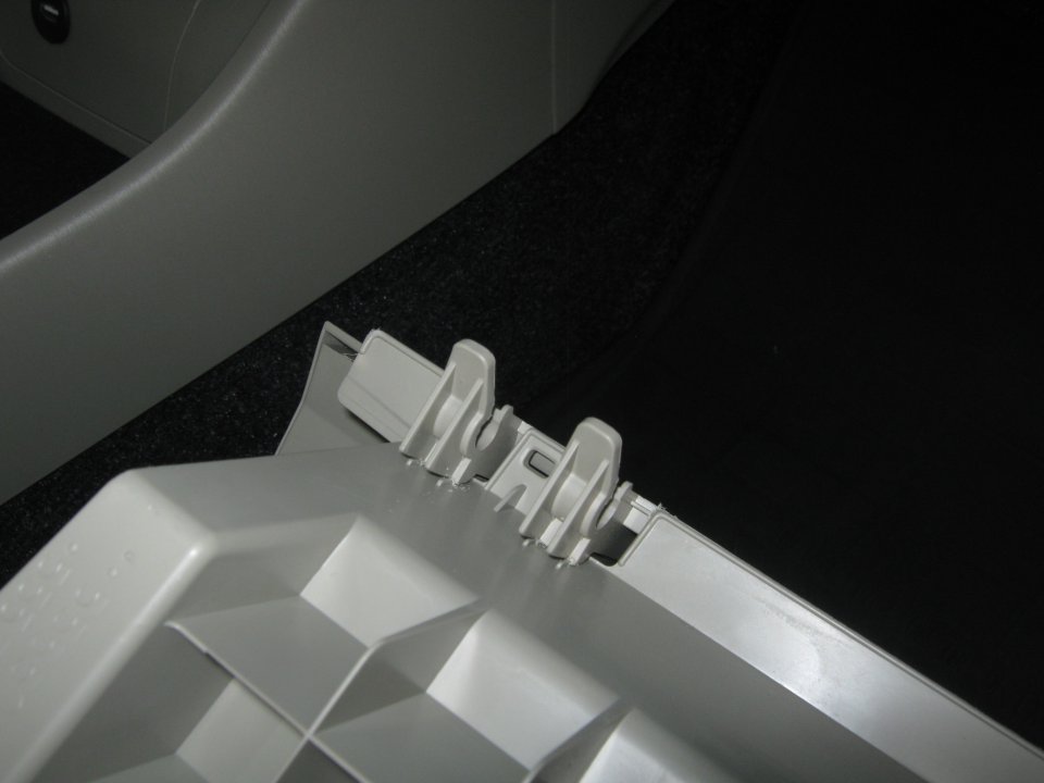

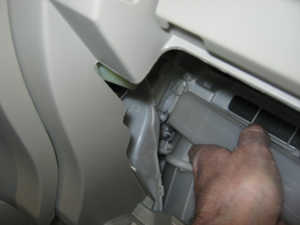

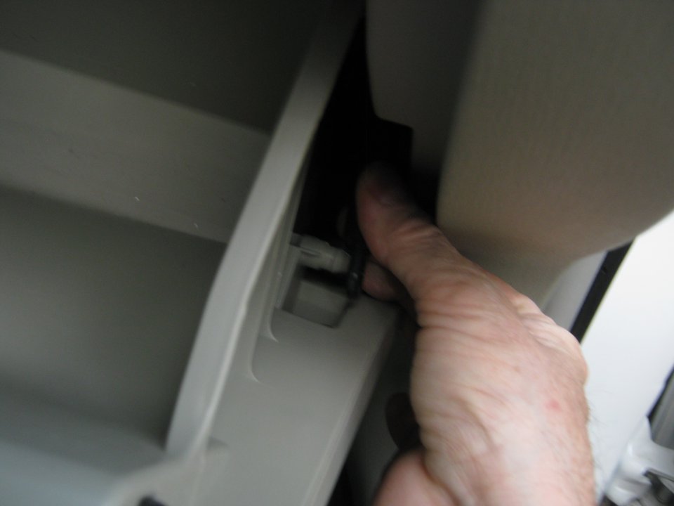

    hey bro.....you or anyone else happen to know how to get the door off the compartment above the glove box?
  4. sfprankster
    sfprankster Active Member
    Sep 25, 2014
    444
    490
    Santa Cruz Mountains, CA
    I haven't had to remove it for anything yet.
    I just tried some pressure(pressing outwards) on the insides of the guides and there's not enough room to get them to release.
    Looks like you might have to remove the dash pieces with the air registers nearest the window and the center console section with the cup holder, to access any tabs holding the upper cover's guides to release it.
    But, just a guess...

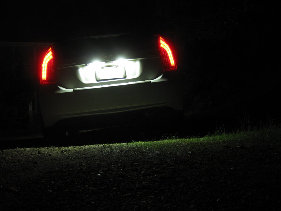

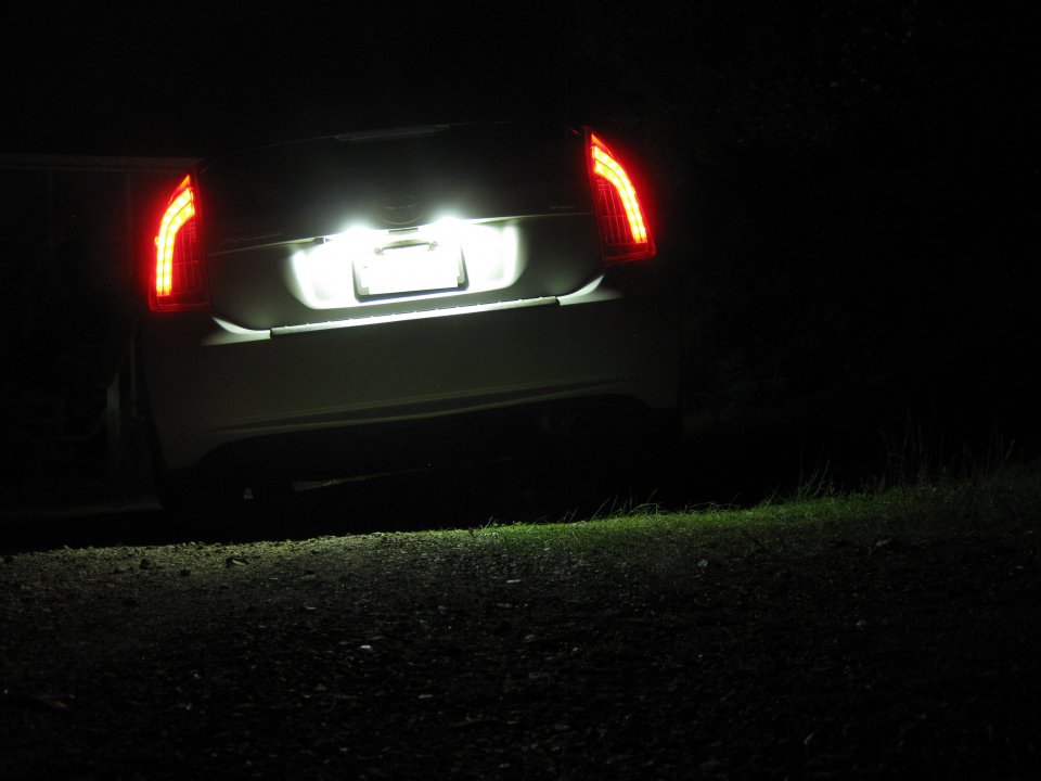

    Hey @sfprankster, quick question for you, when you swapped out the license plate lights, is there any trick to getting the plastic housing out? I was able to swap one out of the lights, but it was very tough to twist it out, even locking it back in place took me awhile. I didn't have enough time tonight to get the other one in.
  11. sfprankster
    Sep 25, 2014
    444
    490
    Did you remove the access panels in the rear hatch?
    Once the access panels(3" x 4") were out of the way, I just reached in and twisted them out CCW(counter clockwise).
    I don't remember them being very tight.
    Have you tried removing the lower rear hatch interior panel to get better access to them? Give you more room to work in. The rear hatch interior panel comes off easily with a little effort with a panel tool.
    Boston Jim likes this.
  12. Boston Jim
    Boston Jim Active Member
    Jun 28, 2012
    202
    148
    Yep, pulled the access panel, spent quite awhile trying to get the first one out, gave up and tried the other side. I was able to get that one off finally and switched out, but still a very tight fit trying to get it back in. I haven't tried pulling the interior panel, but I may try that tomorrow. Thanks.

    Before I switched to the full LED I remember having a problem turning mine as well. I ended up using a longer set of needle nose pliers to put on the bulb housing and turned just fine to remove.
    Or try doing more finger push-ups :rolleyes: lol

    @Accordlayingkit I'll work on the one finger pushups :) I tried to use a small pair of needle nose pliers, gripping only the top portion of bulb housing, but it seemed like it was going to break it/twist just the top only. Today I had time and used a pair of regular pliers (though a bit narrow but not needle nose) and it came right out.
    I switched out the lights on my Prius v as well today and that was sooo much easier, no pliers required. But I did find some scorch marks on the bulb housing (bottom side) - doesn't look pretty on a 3 year old car. The original bulbs looked fine so I'm not sure what is going on, though when driving the Prius v I would just turn on the headlights all the time since it didn't have daytime running lights. Maybe having it on all the time was a bit much for those lights.

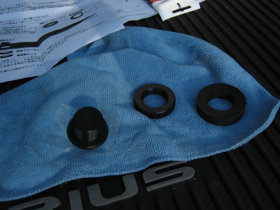

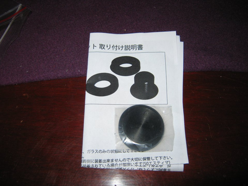

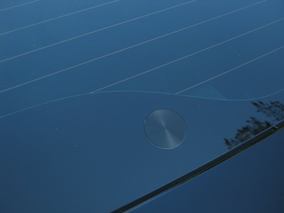

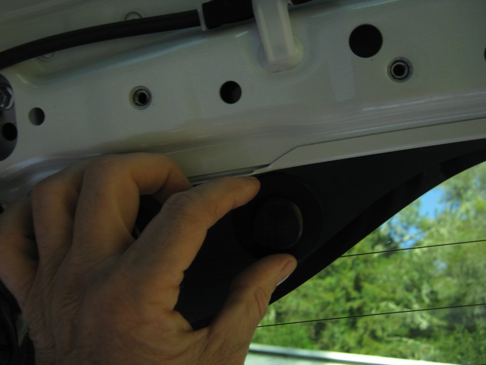

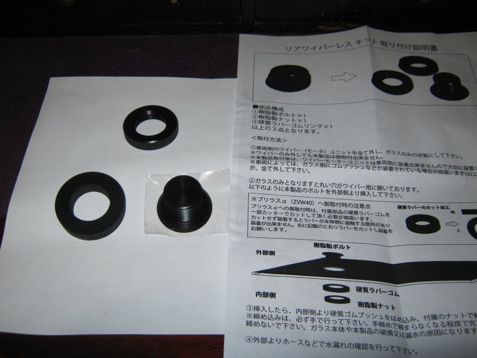

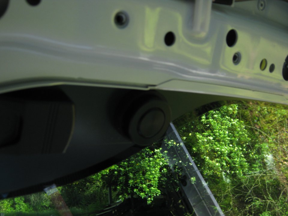

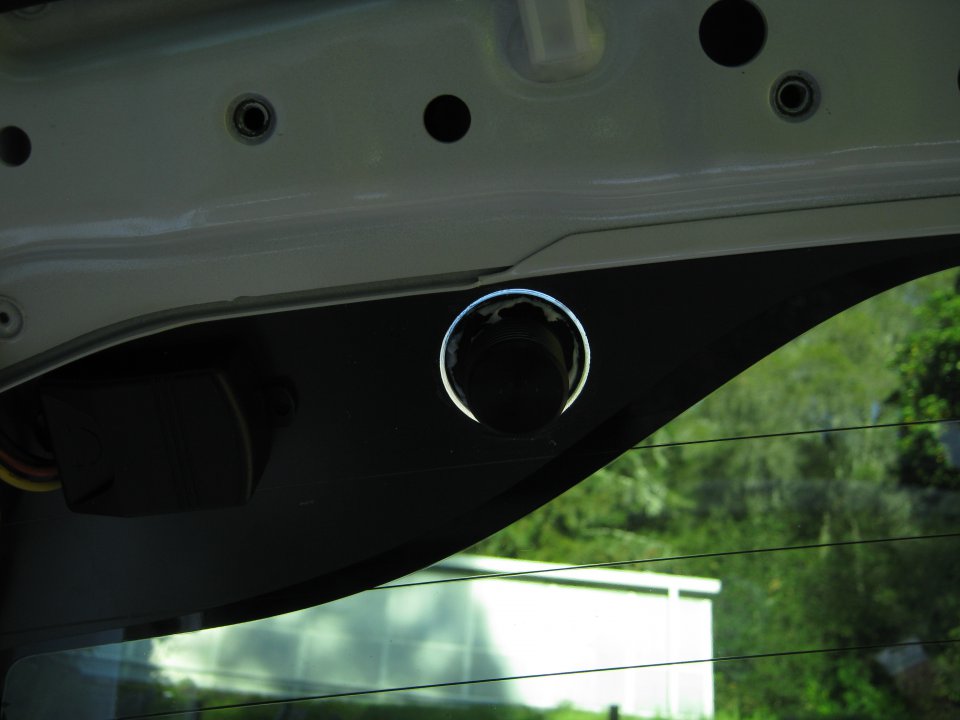

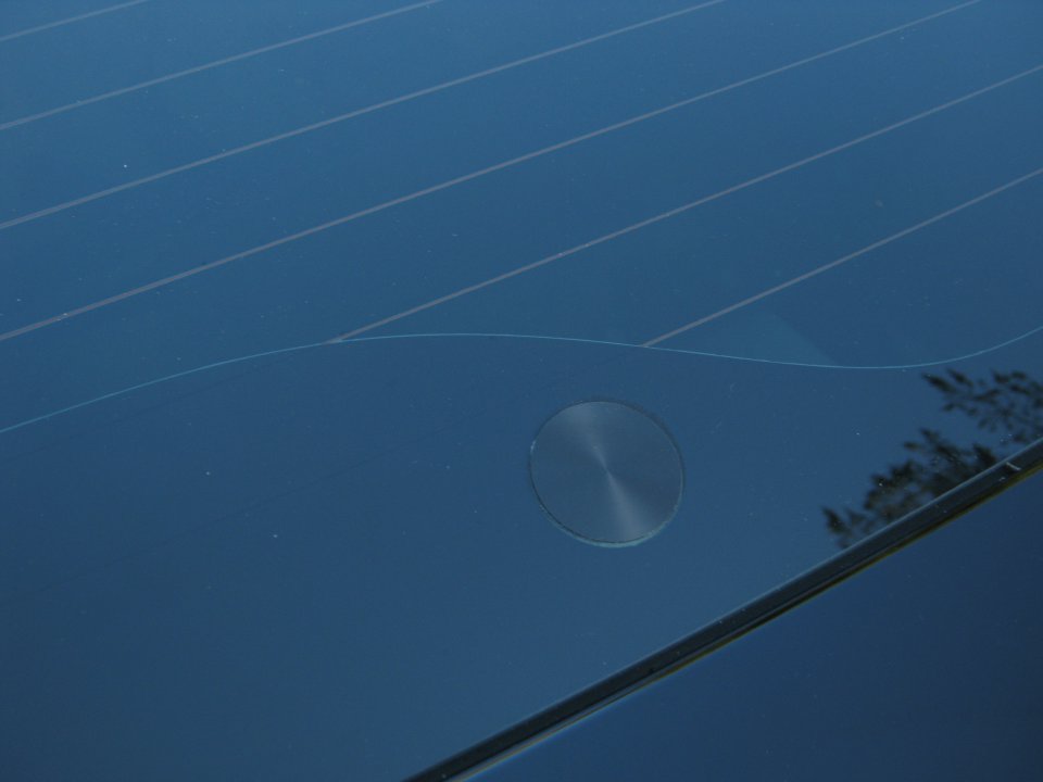

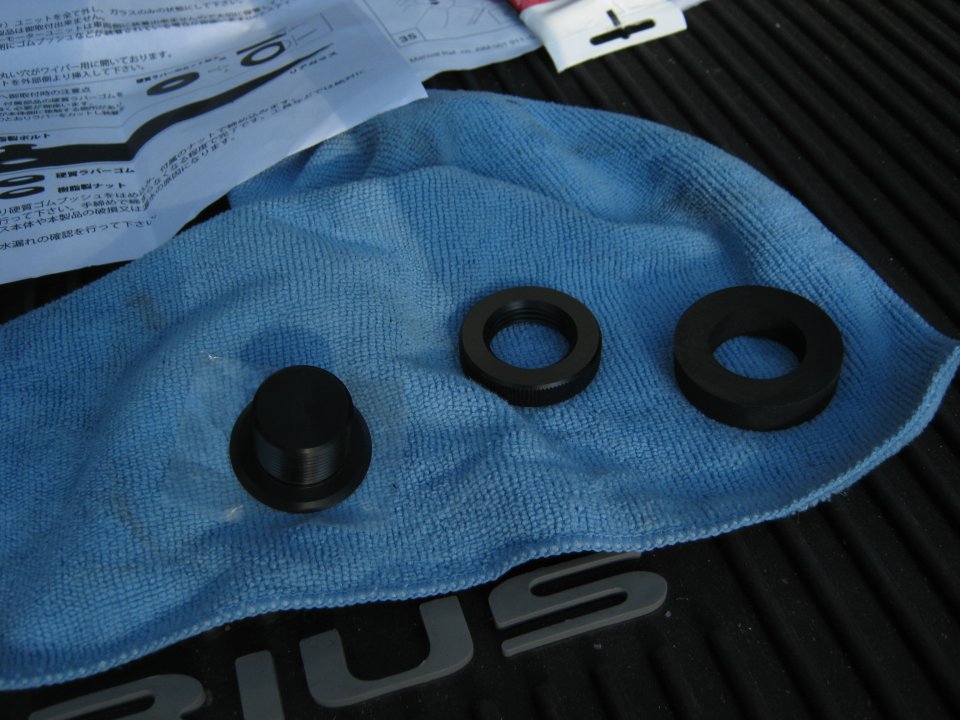

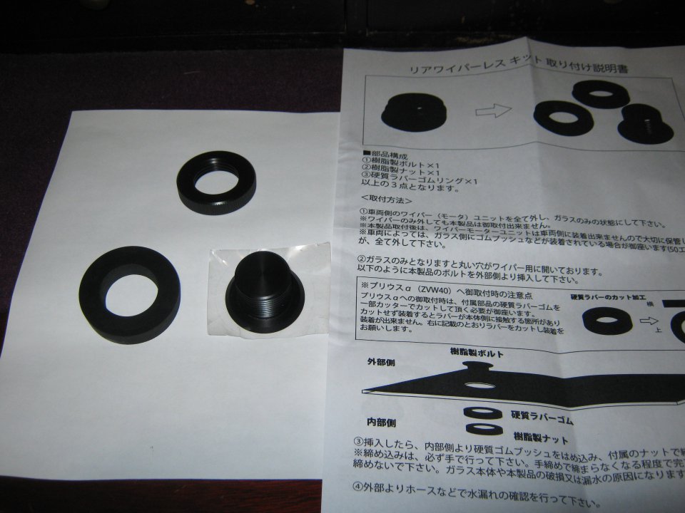

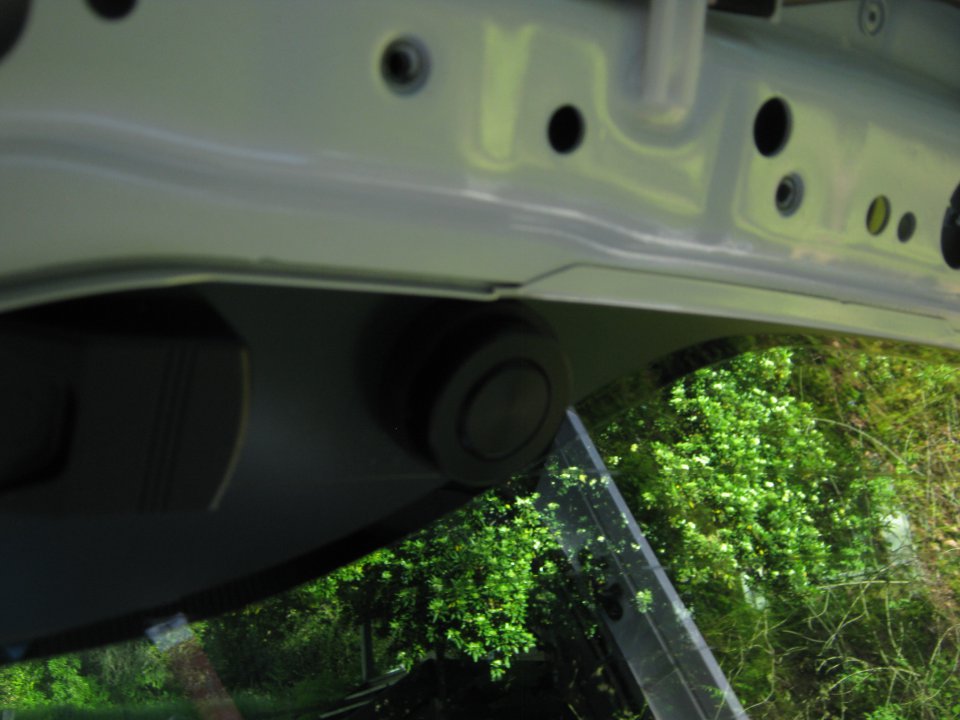

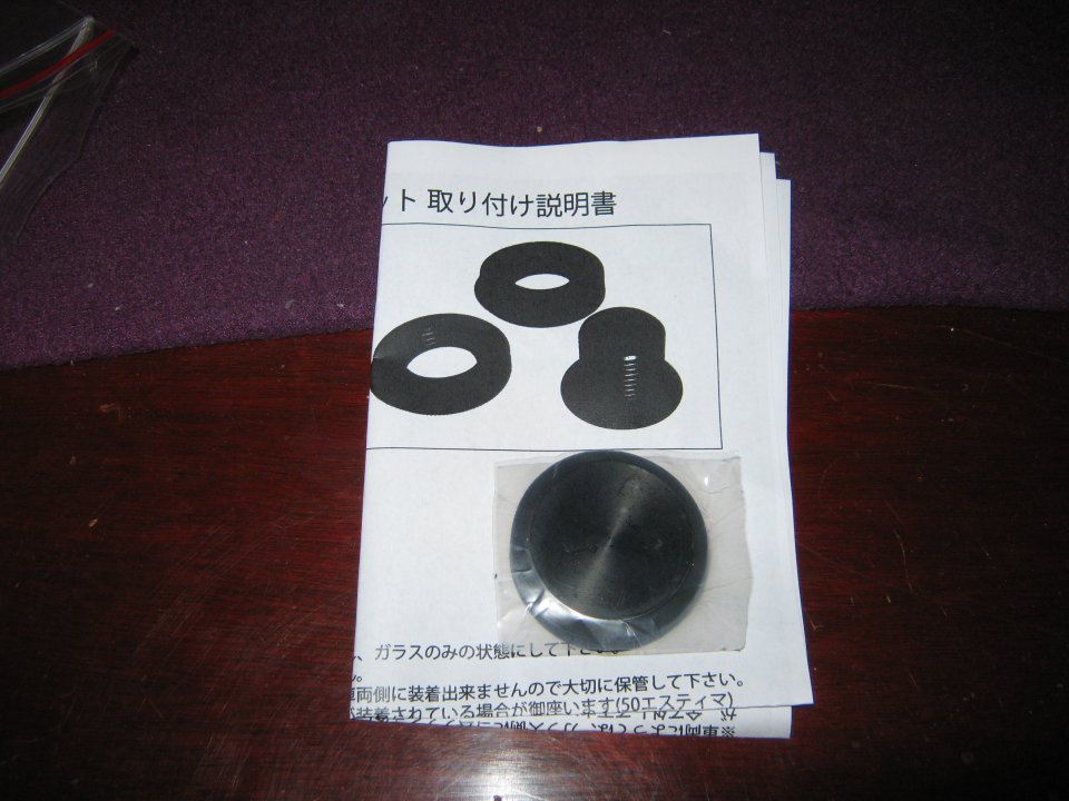

    Can you tell me where you got the window plug for the rear wiper motor delete.
  16. sfprankster
    Sep 25, 2014
    444
    490
    I ordered it through Buyee.jp.
    When I get home on Tuesday, I'll PM you a link.
