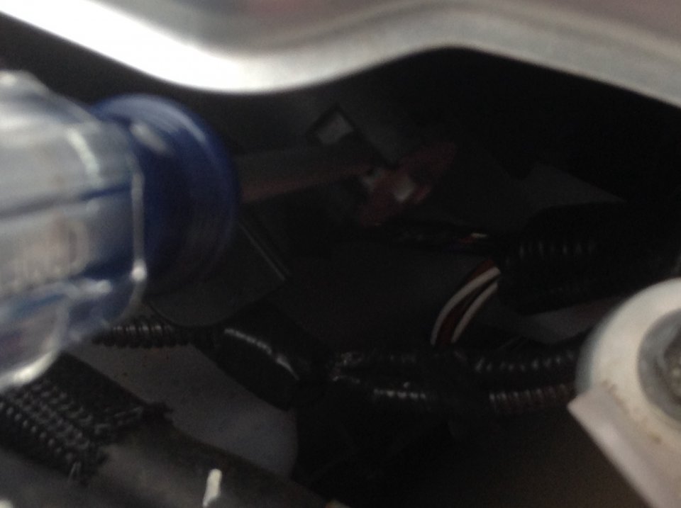

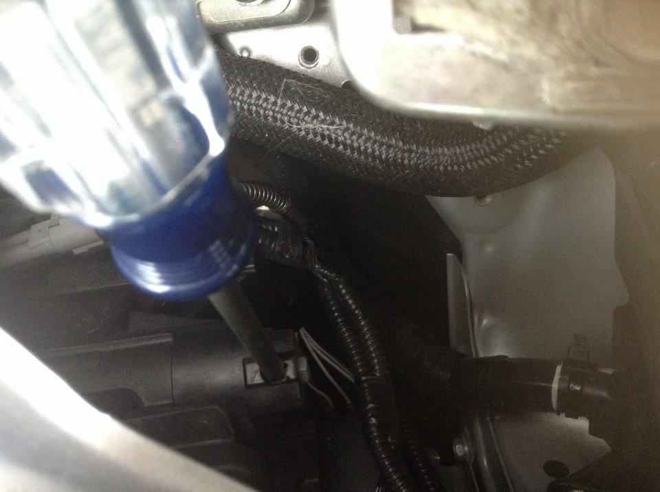

    I did use the procedure in your link, so thank you!
    My headlights were 27 inches above the ground and I used a 25 inch height at a distance of 25 feet to aim the shade line. My left headlight was too high, right headlight was too low, so I adjusted them using a #2 Phillips in the cutout beside the toothed washer in the adjustment mechanism as in the pics below.
    Hope this helps someone else .
