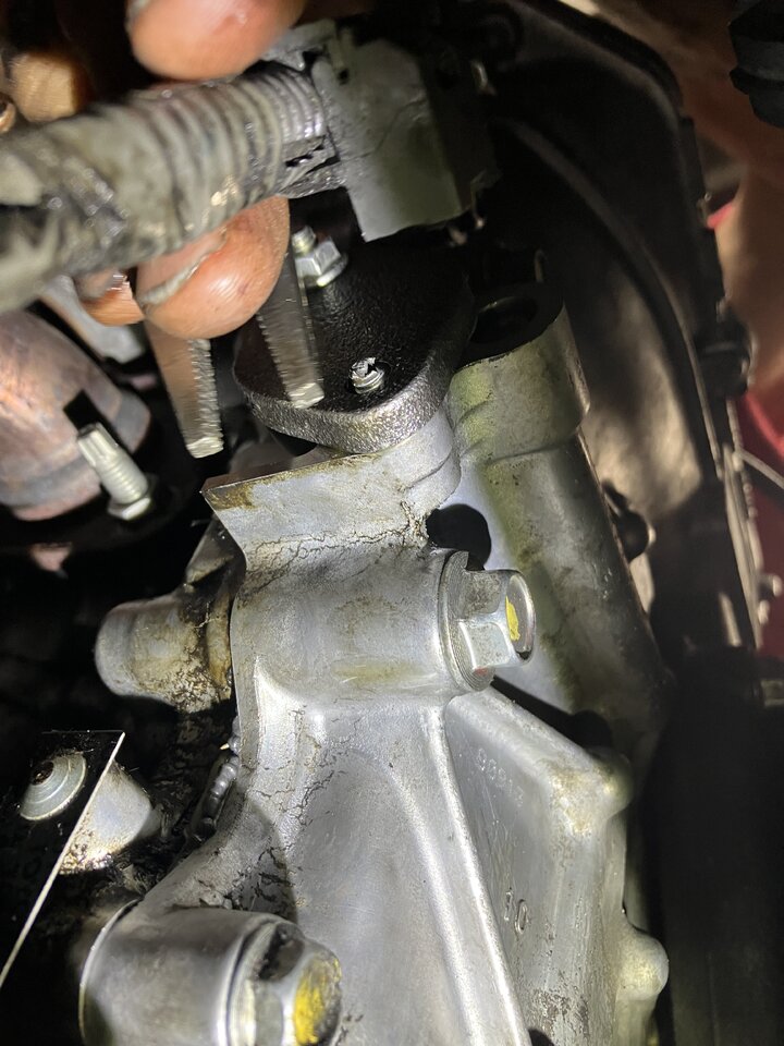

    So, I just finished getting everything back together after a head gasket replacement. Took my time, worked very methodically, but something felt off when I was tightening the nut on the bottom of the timing chain tensioner - it started spinning and I thought I might have stripped the bolt. (I was using a torque wrench and the top one went on just fine, so I'm not sure what happened.)

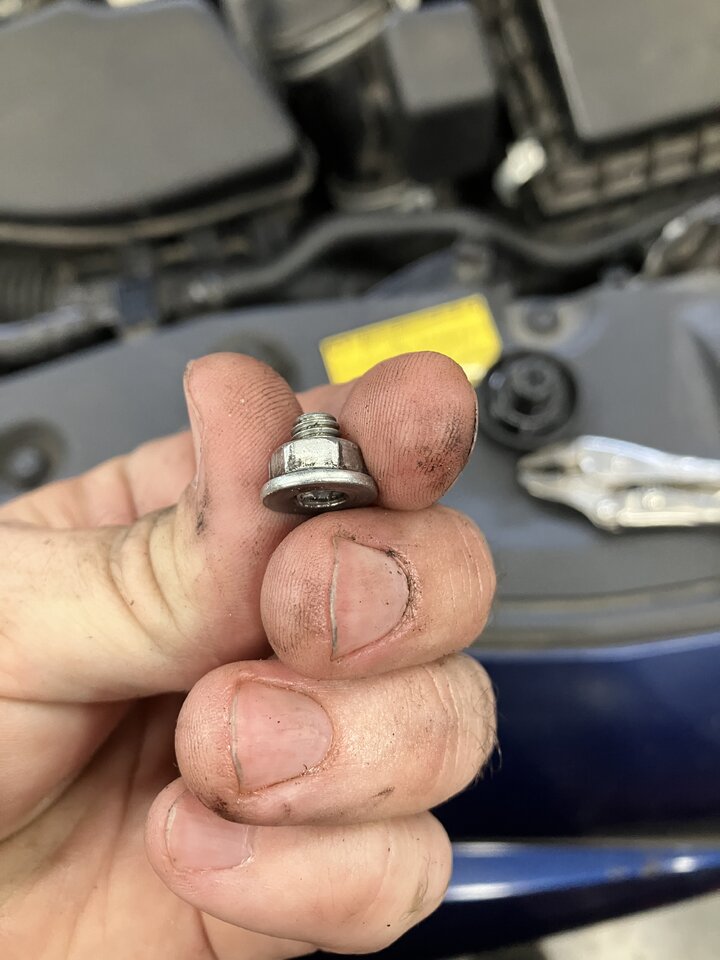

    I figured I'd wait and see after finishing the job. Sure enough, start it up and it's dripping oil from the tensioner at a pretty good rate. I was thinking about putting a second nut on the end of it to tighten down, but I decided to check the existing nut and see what happened.
    Well, it sheared off. See photos.
    To my recollection, these threads are just part of the timing cover itself. Does anyone know whether it's possible to replace the bolts themselves, or does this require replacing the entire cover?

    If really lucky and could get a small slip joint thin jaw pliers after some kroil soaked into threads and clean off stud sticking up. You'd be very lucky . Usually replacement is a thing or removal to get stud out.

    looks like if you remove tensioner you’ll have a decent amount of the snapped off stud protruding, enough to grip by some method.

    Just to wrap this up:

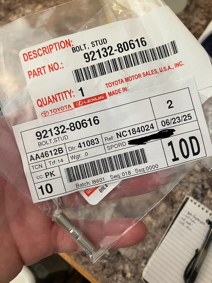

    After removing the tensioner, I was able to remove the stud using locking pliers. For anyone who needs to do something similar, the replacement part number is 92132-80616. These are the two bolt studs that go from the timing cover through the tensioner.
    After getting the new stud in finger-tight, I put the nut on the stud and used it to tighten it just a bit further. I then reset the tensioner and reinstalled it to 108 inch/lbs with a more appropriate torque wrench (previously I'd been using one where that was about as low a setting as it would go, and I likely missed it when it clicked).
