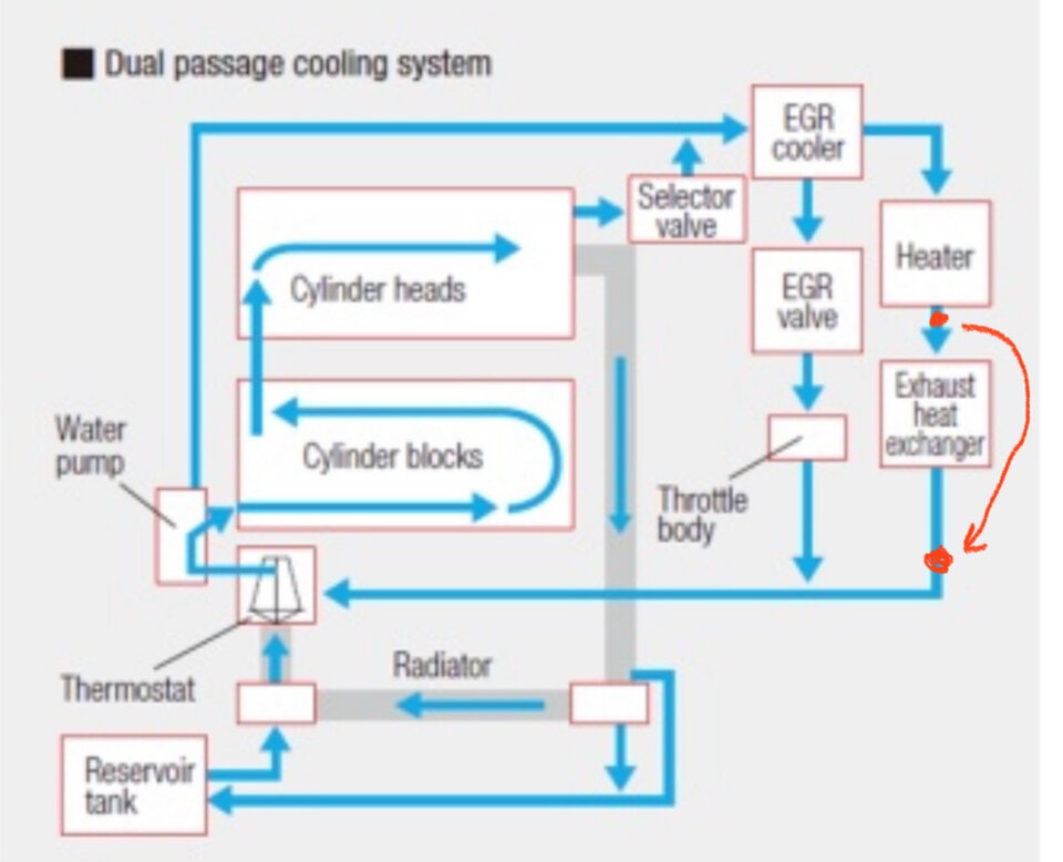

    You have to remove the wiper cowl assembly to access the hoses under the hood. Or you do from underneath but have to rig a bypass hose.
    Gen4 Cooling system (Does not apply to Gen3)
    When done from above you end up with two hoses going down to the heat exchanger not connected. Some would plug, others do not.
    Gasketmasters Video with Gen4 bypass last half. Starts with Wiper assembly removed.
    Read the comments but realize some are gen3 questions. The secondary cooling loop is different and would not work as shown above.
