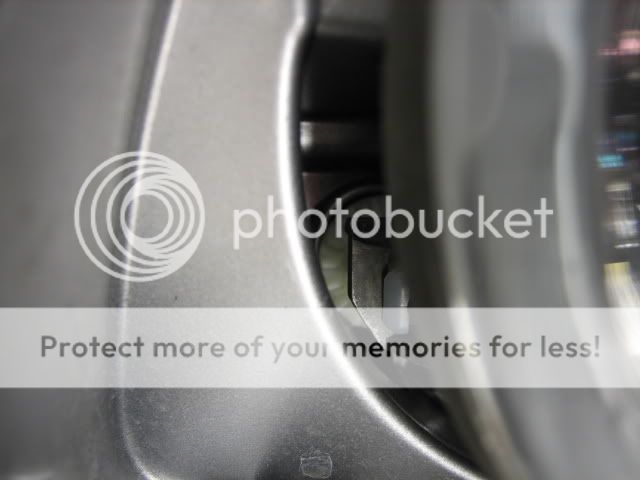

    Here is a picture I took of the adjustment wheel for the foglights.
