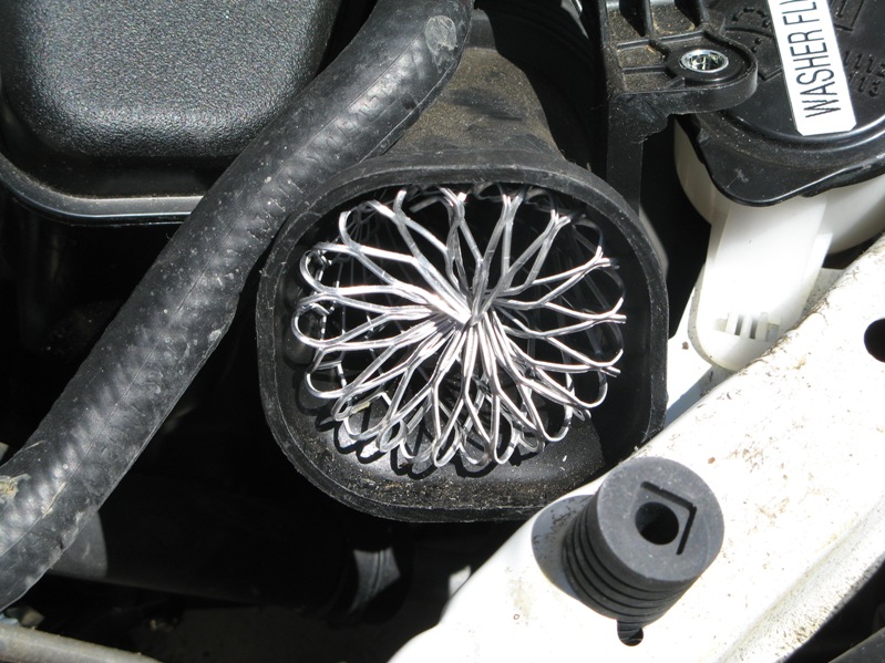

    While I have had no mouse or rat intrusion into my Prius"v," I decided to ad an air intake screen.

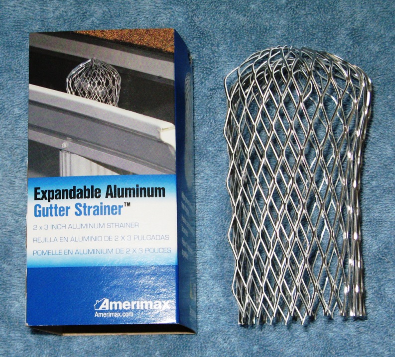

    I made it from this aluminum expanded metal "gutter strainer" that cost me $2.32 plus tax at Home Depot.
    Amerimax Home Products 3 in. Aluminum Leaf Strainer-21048 at The Home Depot
    To get it small enough, I used a pair of "dikes" and cut off 2-1/2 inch or so off the side end.

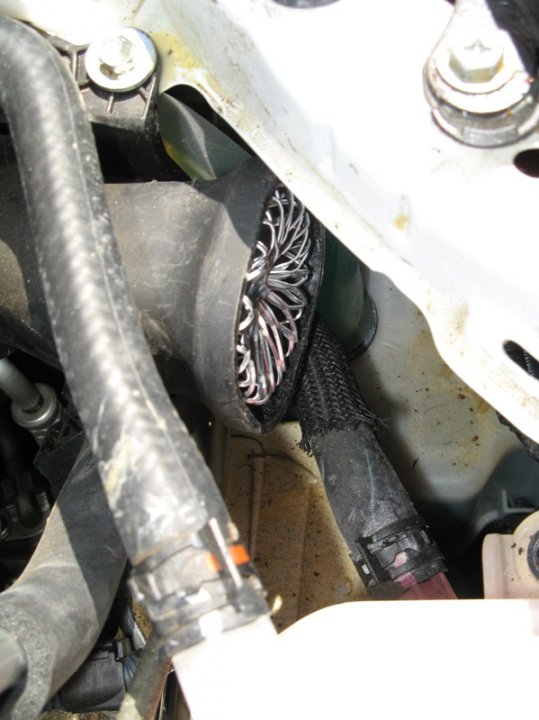

    Then, I took off the M6 bolt with 10mm hex head that held the air intake to the car's radiator support. The guard needs to be rolled very tight to get it past the two "pop" rivet ends that intrude into the air intake's opening. Once in, the guard expands and locks itself in with the tow "pop" rivet ends.
    Pushing the center of the mesh in finally expands it to fill the opening.
    Cheap insurance!

    A mouse can flatten down to get through a 1/4 inch gap, but cannot get through a 1/4x1/2 inch diamond shaped hole. If it flattens itself to 1/4 inch, it will get wider than 1/2 inch.
    It would be even tougher while it is hanging on the wire screen.
