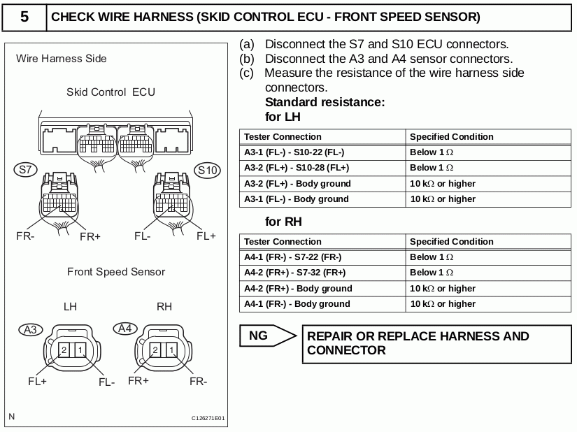

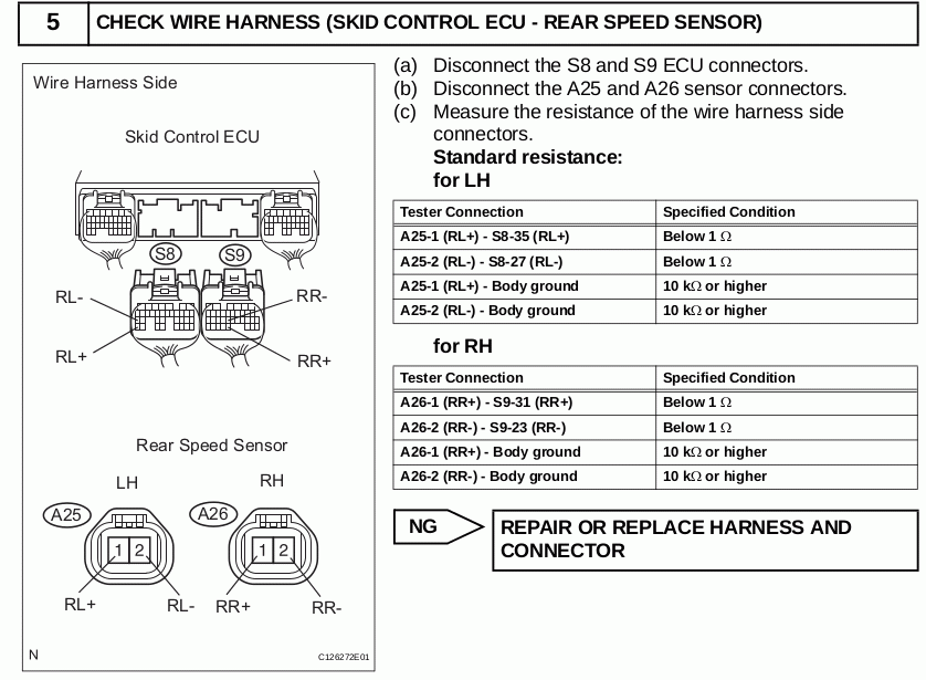

  20. nh7o
    nh7o Off grid since 1980
    Dec 10, 2011
    1,686
    340
    Hawaii
    Here is how to check the harness to see if the speed sensors are connected properly to the Skid Control ECU. You can check the 2 ABS relays, and the 2 MTR relays, but I doubt there is any problem there, as relays rarely fail. Beyond that, you need an oscilloscope to be totally sure that the speed sensor signals are making it to the ECU with proper waveform and amplitude. You can get the speed control pdf from Toyota Tech website that shows how to do that.
