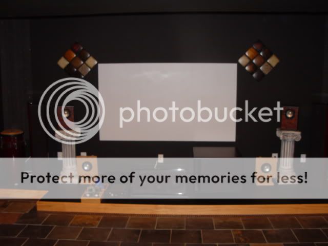

    There is no substitute for real slate. Like above, it is a nightmare to install but it also has its advantages:
    Its randomness makes laying it somewhat easier...you know it won't be straight, you know it won't be level so the amount of prep is a bit less.
    Here is my theater room that we recently finished:
