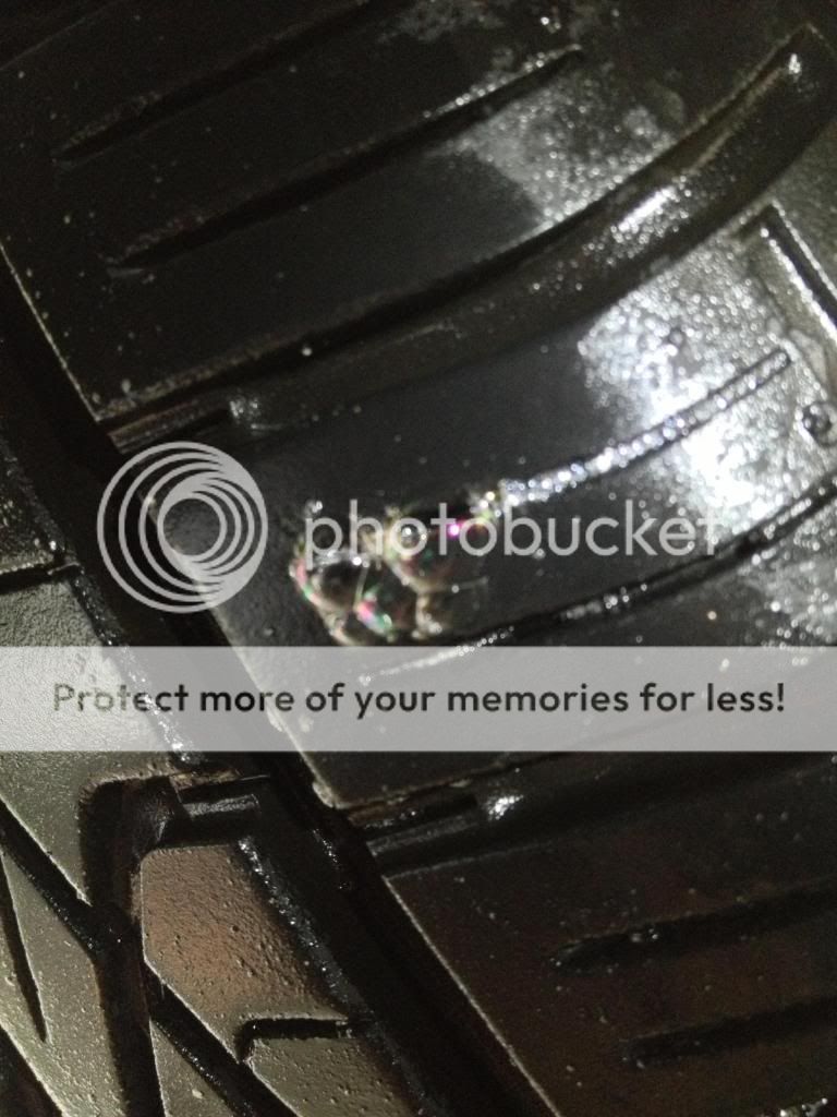

    Ive been losing 20psi every week for the past month and Ive finally had some time to fix it. Im not sure if you can see it in the picture but that pebble is only about ~2mm wide. I didnt even know a pebble that small can cause a leak. Anyway, I figured a leak that small would best be fixed with some slime. But can you use slime with tpms? If not, i guess ill just have to open up the hole and plug it up. Or are there any other ways to fix it?

    Do not use slime. Do not use a plug by itself. Have the tire removed and patch/plugged.

    To TwoUnderPar with respects and as to your edit. There are limited times when a plug alone is sufficient as a temporary fix, but should never be used solely as a permanently repair on a daily driver. It has been done in the past and is sometimes successful, however this is not the best, safest or industry standard solution for modern street tires. Reputable quality shops will not do it. sLick415 just pay the tire shop the $20 or whatever and be done with it.

    I did a plug repair on a very similar location, judging from the pic: looks to be near the corner. It was a small diameter nail. Post repair, the wheel sat in the garage through winter, held air fine. Has been back on the car for about 500 km now, and still fine. That said, I've heard concerns about punctures near the tread edge like this, so watching it closely.
    FWIW I used a BlackJack Tire Repair Kit

    That's really near the side wall, since the hole is pretty small, I would recommend you take out the tire and patch it instead of plugging it. I know most auto place won't patch it if its too close to the side walls due to liability issues. But if you want, you can make the hole bigger and then plug it. Thats my option if I do it myself since patching require you to take off the tire and remount it afterwards.

    Well I'll probably take the tire off and give it a good patch. I can do this without touching the tpms right?

    A tire shop might not want a patch repair from the inside, with it being that close to the corner. At least that was my experience. And a plug repair is a relatively easy DIY, so I went that route.
    There may just be a good reason for not patching, by any method, that close to the corner, but I thought give it a try. The nail in my tire was very slim. The plug repair kit I got (see above) comes with 2 diameters of plugs. I used the smaller, worked carefully, followed all the steps, and it seems just fine.

    I wouldn't recommend pulling out the tire if you don't have a tire remover machine. I've done quite a few patches myself when I was working at Toyota on the Prius, and even then, I broke one TPMS sensor. Which costed around 50-70$. I've never removed my own tire without a machine. Since your tire puncture is really near the sidewall. Dealers or autoshops won't repair it since its a liability issues. I would suggest you get a plug kit, then drill the hole bigger so the plug would fit through it without taking the tire off of your rims. That is the easiest suggestions I can recommend.
    But if you really want to learn how to do it yourself by taking the tire out, by all means do it since you'll be the one replacing anything that you break. And yes, the TPMS will be in the way and to remove it, its hold on by a 10mm bolt. Good luck and let me know how it went :)
