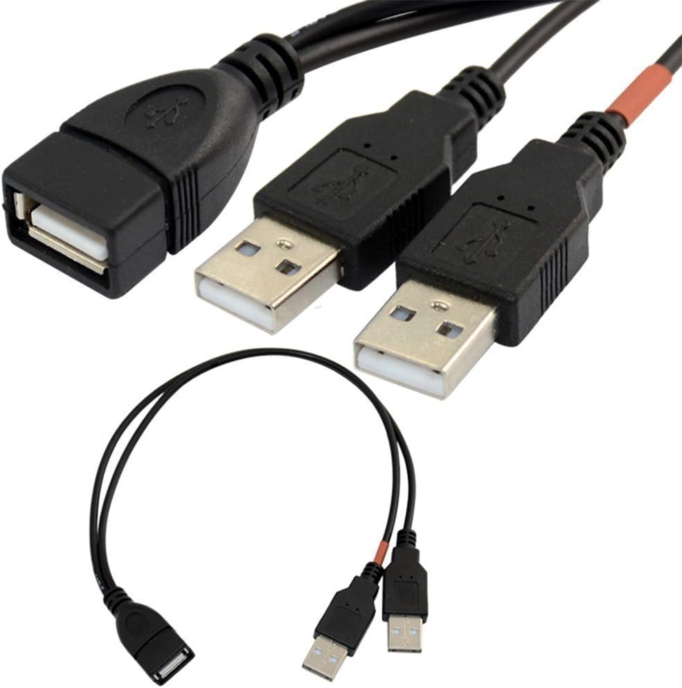

  11. BobDiego
    BobDiego Junior Member
    Sep 24, 2021
    San Diego
    It looks like Amazon has a USB adaptor that will accommodate this function in one cable ($7 soluution):
    HIGHROCK 30cm USB 2.0 a Power Enhancer Y 1 Female to 2 Male Data Charge Cable Extension Cord(1pc)
    About this item
    • 100% Brand New USB 2.0 A female to dual USB A male Y Power Enhancer cable.USB 2.0 A female to dual USB A male Y Power Enhancer cable.
    • There are times you may have an external device, such as a portable 2.5 hard drive, and a standard USB cable is not able to transfer enough power to operate the device.
    • Does one USB port not supply enough power for your USB device This Sync USB Power Adapter Y cable for your is the solution.This cable allows for power to be taken from 2 USB ports, like a PC and External hard drive.
    • USB 2 Male TO USB Female Allows you to link 1 USB device into 2 USB Ports on your PC for more power.
    • Note: The red marked Male cable is just for charging to bring more power; Another is Charging & Data Sync Cable
