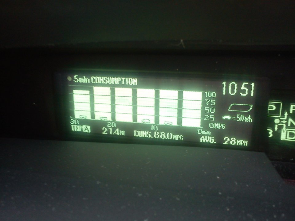

  20. Patrick Wong
    Patrick Wong DIY Enthusiast
    Mar 8, 2008
    18,210
    6,517
    Green Valley, AZ
    Notice the engine coolant temp is only 53 degrees C - pretty cold after driving 20 miles. But I guess that is to be expected if the ambient temp is 8 degrees C.
    How much cabin heat are you getting under those conditions?
