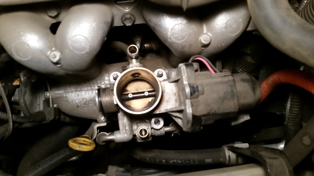

    Well the throttle body was dirty but not sticking and the operation was smooth. I cleaned the butterfly valve and sides of the throat. I then drove the car on another 14 mile trip. Truthfully I didn't notice any improvement from the throttle body cleaning. But the car is behaving much better, not fully up to normal though, having dumped the Seafoam in the tank last night.
    I'm wondering if this was all about dirty fuel injectors?
    I bought another can of Seafoam at Wal Mart.
