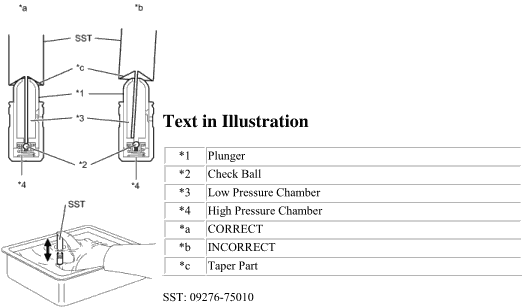

    They're auto-adjusting, on oil pressure. If it takes a couple seconds for pressure to build they might tick.
    They have tiny check valves in them that might help slow down the oil draining out while you're parked. The repair manual shows a technique for testing those. Maybe a check valve got sticky in the egg crate?

    Thanks ChapmanF that sounds exactly like what's going on, a perfectly reasonable explanation. I won't bother with the test now that it's back together and sealed up but if I ever have a 2ZR apart again, which no doubt I will.. I will definitely test them before fitting.
