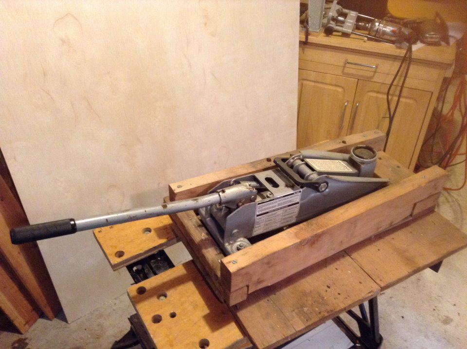

    I tip my hat to you for the decades of experience, but still have a couple of tips, things to take along:
    A pair of tire chocks (cheap lightweight set, placed on either side of the tire diagonally across from the flat)
    A square of 3/4" thick wood, say 6" square or more (to spread the load under the scissor jack on dirt or gravel)

    I absolutely agree with you! What I finally did was get a good hydraulic jack and build a platform to hold it so that I could use it on soft surfaces:

    Your advice to use wheel chocks also quite right, of course, and thanks.
