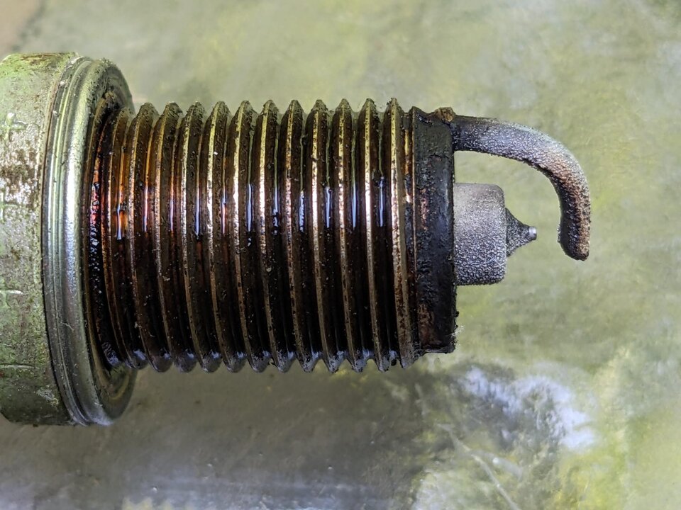

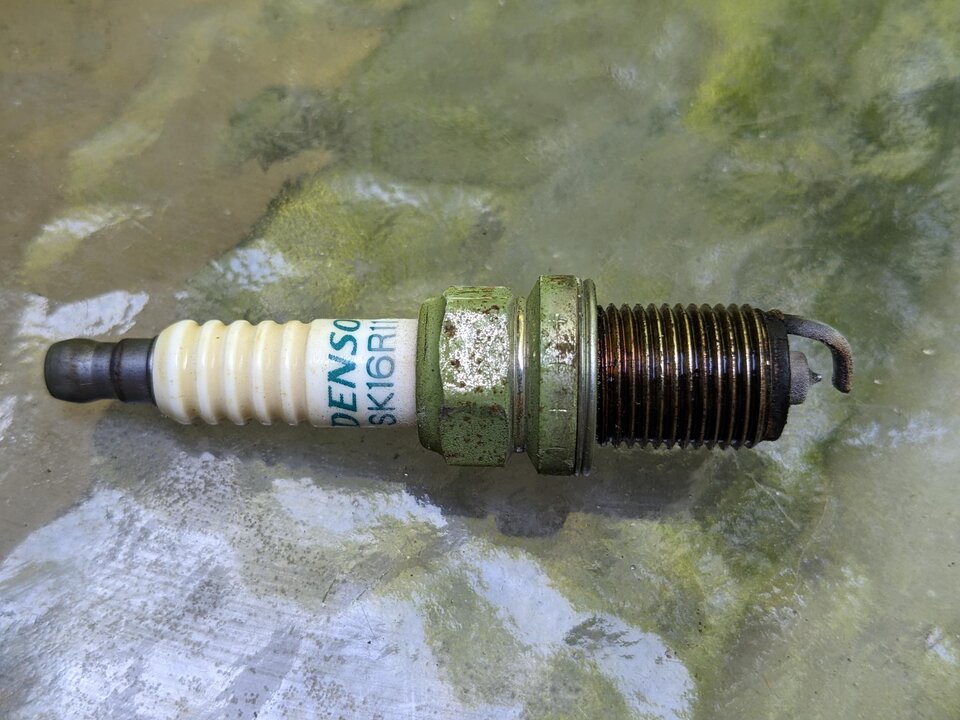

    I had some spare time today so I decided to change the spark plugs for my 08 Prius with 99,000 miles, purchased 3 years ago at 65,000 miles and unclear as to whether the spark plugs were ever changed or not.
    The car was running just fine prior to the change, consistently getting 45-55 mpg (albeit with an occasional P0420 code), so I wonder if the change was even necessary?
    For your reference, below are the photos of the old plugs, Denso SK16R11 Iridium. I'm also curious to know if the crusty tip of the plug is a sign of a future engine problem that I might have to deal with.
    The new spark plugs I got were E3 3.48 premium plugs, incidentally.
    Thank you!

    IMO, you were better off with the old Denso plugs versus the new E3 plugs. How many miles do you think the E3 spark plugs will last

    I just took mine with at least 100k on them and look exactly like yours! Ordered a new set of NGK 4996 (OEM plugs) from RockAuto for $6.50 a piece. Id stick to NGK or DENSO all day, i would never put anything else on my Toyota or Honda engines.
    The brown tip is a sign of normal wear, as long as they aren't wet with oil, i’d say its normal wear.
