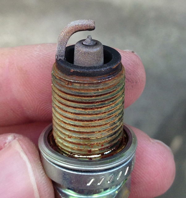

    I'll let you know. I just changed them yesterday. You wouldn't believe the rust I had on the top part of the plugs and threads. No more engine wash-down for me.

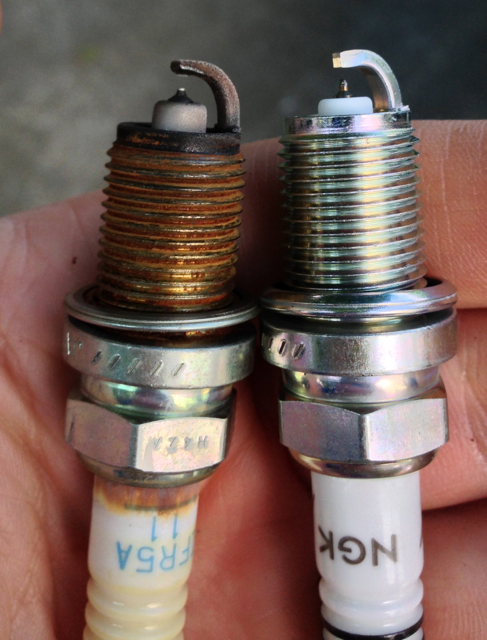

    One thing I noticed is that the existing plugs were NGK. Does that mean they had been changed before? I'm at 141K, and I bought the car with 100K.
    Here are a couple of photos:

    BTW.. Advanced sells the Denso now ($9) but I went with NGK ($7)
  11. Patrick Wong
    Patrick Wong DIY Enthusiast
    Mar 8, 2008
    18,210
    6,526
    Green Valley, AZ
    NGK and Denso both provide original equipment iridium plugs to Toyota for the Prius. The old plug in your photos had accumulated sufficient deposits so I would say it had not previously been replaced.

    Other than the slightly rough appearance from the deposits, the electrodes look very well shaped. That makes me wonder whether the plugs can still be used for a very long time.
