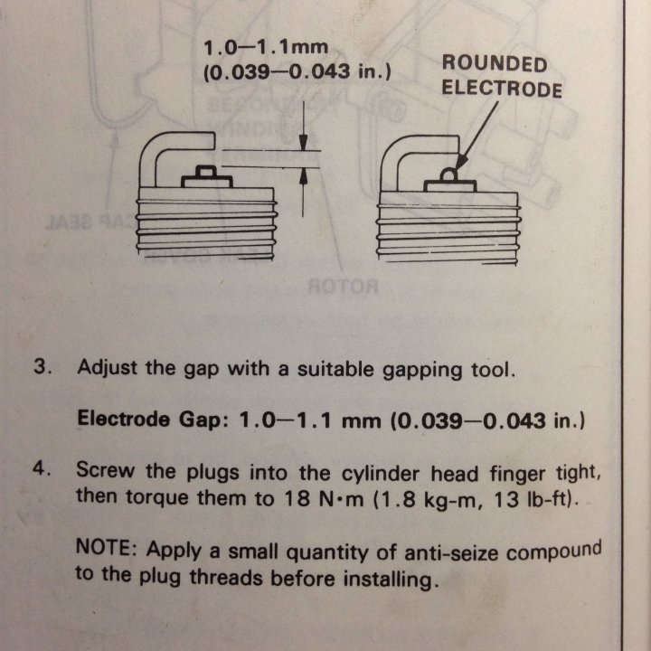

    Honda Service Manuals I've collected over the years advise to use small quantity of anti-seize on the threads.
    In my Toyota Prius Repair Manual pdf I see precious little about spark plug install, not even a torque spec. Maybe missed it.
    Pic from Honda Manual:

    I guess I'll just remove them for inspection and put them back. What's the torque spec?
    Edit: Found the torque spec. It's only 13 ft-lbs. Is that correct? That's possibly the lowest torque for spark plugs I've seen.

    Where'd you find that torque spec?

    On PC and the web... 2nd gen spec.

    13ft-lb is correct.
