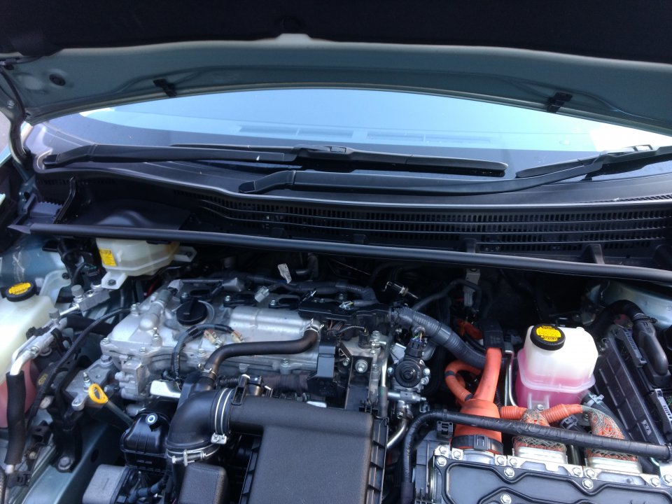

    Hi guys,
    I don't know if anyone else used/found this way of removing the Spark Plugs . If yes or double post , please ignore or delete it
    Hope it will be usefull to you
    Sorry for my English...I'm still improving it :)
    Enjoy

    That’s the English version (or right hand drive);).
    The clearances are different than the left hand drives where the windshield wiper cowling hangs over more:cool:.
    So for you in the UK, this will work. But I’m other parts if the world, we’ll be pulling the cowling (y).

    I still don't get it ... if the big, double-jointed passenger wiper is such an important thing to wipe enough of the big windshield in LHD countries, why does flipping the car left-for-right make it not important?

    U.S. FMVSS No. 104, Windshield wiping and washing systems is, as I understand it, more stringent as to the wiped area than are European, Japanese, or Australian wiper standards. I imagine Toyota found it less costly to design and test only one version of the LHD wiper system for sale in the U.S. and other markets.

    As @ChapmanF points out, this isn't the first time we’ve seen this;).
    But a shorter windshield wiper cowling makes the job easier(y).

    So, this method not going to work on US Gen3 Prius? I hate to remove all dash since i have enough tools.

    Nope, you need to remove wipers, plastic trim at bottom of windshield, wiper motors and linkage, and the metal cowl below..
    @NutzAboutBolts pulled everything off when doing the spark plugs on his 2012, not something you do unless you have to, lol. Video linked in a thread pinned at top of 3rd gen Maintenance Forum. Good video to watch, shows everything involved.
    One thing he says to use 20 foot pounds on the new plugs, after liberal coat with anti-seize. Shop Manual recommends 15 pounds, presumably with dry threads, which is maybe preferable. With anti-seize I would use very sparingly, and maybe reduce torque to 12~13.
    Socket size is 9/16", or 14 mm? I used the 9/16" size, but I believe 14 mm is the kosher size.
