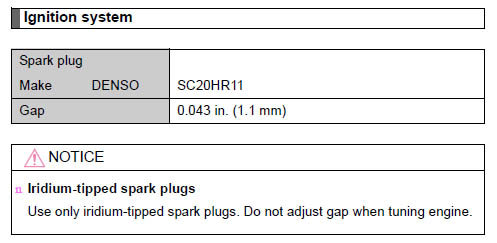

    Question: Are the stock plugs double iridium or platinum?
    I may set a record on leaving them in the longest. ;) I agree, the Prius is very gentle on plugs.
  19. Mendel Leisk
    61,604
    42,380
    They're iridium. It's a royal pain to get at them, see NutzAboutBolts excellent video on the subject.
    From 562 of the manual:
  20. Bill Norton
    Bill Norton Senior Member
    Dec 15, 2012
    2,247
    754
    MONW, Ks.
    2019 Prius
    L Eco
    Some plugs have iridium on the electrode and the ground post, "double".
    Either way, I'm taking it to the limit!!
