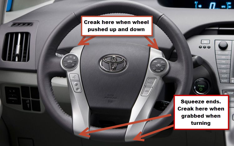

    Is your "creaking" the same noise you hear when you lean on the armrest? Try squeezing the ends of silver plastic on your steering wheel. Try pulling your steering wheel up or down.
    I had this problem about a month after buying my prius. Get a can of WD40 and spray within all the edges of the silver plastic on the steering wheel. Wipe off any excess wd40.

    My mechanic did the spraying. I just watched him do it. Don't do it if you feel uncomfortable. Take it back to the dealership if you are still under warranty. I'm still not sure if you have the same problem as me. The silver piece(s) on my steering wheel was creaking when it was put under pressure. I showed my mechanic the problem by:
    1) Squeezing the bottom of the end of the plastic piece. (When you make turns you end up randomly grabbing different parts of the steering wheel. If you are unluckly you end up grabbing the plastic part to make it creak)
    2) Pushing the steering wheel up and down. (this causes the top part of the silver plastic to compress and creak)
    The mechanic fixed it very slowly using the red straw that comes with a can of wd40. He pressed the can nozzle very lightly. He wiped and caught any excess liquid as he sprayed. He turned the streering wheel upside down and in every direction to ensure that he always sprayed from the top. He paused after every spray to let the liquid settle. He sprayed on all outer edges of the silver plastic (not on the buttons).
    I am just trying to share where I found my creaking and its solution. Spray at your own risk.
