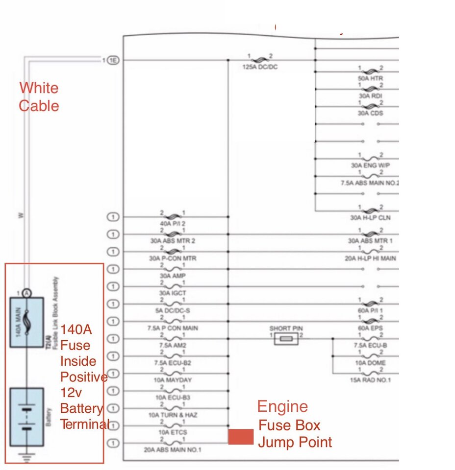

    You should supply a little data when asking for help. Voltage of 12v when off at battery and at engine jump point.
    Its almost certain if a jump AT THE BATTERY starts it, its the battery.
    Second, measure voltage with car off at the battery to ground and then at engine fuse box to ground. If engine side is low to zero there is a blown fuse or disconnected plug at the battery positive terminal.
    #2 rjparker, Aug 11, 2026 at 12:40 PM

    if you're jumping to the point in the fuse box, you have a problem in the wiring between the battery and that point.
    check the voltage at the battery, and then the jump point
