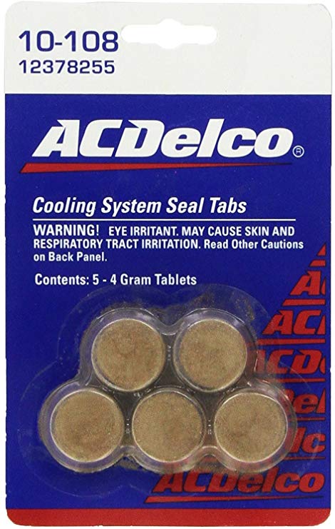

    i did major EGR and heat exchanger cleaning at ~110,000 miles, actually replaced it with newer, low mile ones that i precleaned too. combined it with oil, coolant, and plugs change. it was quite a huge maintenance. coolant level slowly dropped since that and i didn't think much of it. fast forward 15,000 miles and almost 2 years. i came back from a 1 week long travel and started the prius. it wasn't even cold. it knocked for a few seconds. previously i only had that after shutting it before it warmed up properly. i said to myself Uh-oh. i checked the coolant reservoir and it's empty. took a liter of pink coolant to refill it full. no coolant in oil though and the car runs as well as ever, maybe noisier under low speed high load conditions. there are no leaks that i can see.
    so, i'm thinking:
    1. the whole EGR valve and heat exchanger cleaning doesn't prevent a thing.
    2. i need to something more radical.
    how about this?
    BTW, Thanks!

    Test the head gasket integrity with a leak down test? Toyota makes a gasket kit, includes head gasket and pretty much everything. A lot replace the head bolts too, for just in case.
    I would pass on those AC Delco tabs.

    That is a GM solution I swear by on an HT4100 engine. (See Cadillac Forums in the '85 de Ville FWD section. Quite controversial, I swear by it that it stops water pump failures in that engine. GM put warning labels on cover on top of the radiator with the part number of those tabs). GM apparently sent out TSBs that it was no longer required, but I still have that whole package in our system.
    If you're burning coolant, (coolant into exhaust) there is a product specifically for that which is worth a shot called K-Seal. Have that in another car. Follow directions carefully.

    I'll try one of those liquid HG fixes before doing anything more invasive. now that i think about it more why would HG fail on such low miles, i'm thinking maybe it's related to thermal cycling. most of the miles on my car is city driving, like about 80,000 miles. that included 3-5 trips a day. each with near full cold-hot-cold cycle. furthermore, i drive mostly using pulse and glide meaning numerous start-stop cycles during each trip. that's even more cylinder temp fluctuation. i'm thinking the OEM HG is not good enough for all that thermal cycling. maybe if i drove mostly hwy, the defect would show up much later, closer to 200,000 like most reports i'm reading.

    Welp I disagree with just about everything you said:
    1. The stop-leak quick fix
    2. "Thermal cycling"
    3. Toyota head gasket quality
    4. You're good for 200K if you drive highway
    Nope, not just about, it's everything, lol.

    Fair enough:
    1. The stop-leak quick fix <buys you nothing but a month or two, makes a royal mess of the coolant system
    2. "Thermal cycling" <Gasket Master's theory, while the smoking gun is a carbon chocked EGR. Their expertise is replacing head gaskets fast/cheap. Even they say in one video "it's always cylinder one". Wonder why... Thermal expansion? Or that's the cylinder one EGR port is the one that clogs worst and first.
    3. Toyota head gasket quality <Likely the best head gasket going.
    4. You're good for 200K if you drive highway <Seriously doubt it. If anything, the protracted high speed will accelerated the EGR clogging.

    From the horror stories I've seen in these forums, those stop-leak products don't seem to play well with this car. If it's really the HG (check cylinders in morning for fluid, or find a guy who's good at leak-down testing), it's a matter of time before you replace the HG or end up needing an engine rebuild. The stop-leak thing is a seductive temptation, but the fact that you already had a rough start is a huge red flag. And I'm not talking about a one with a friendly maple leaf.
