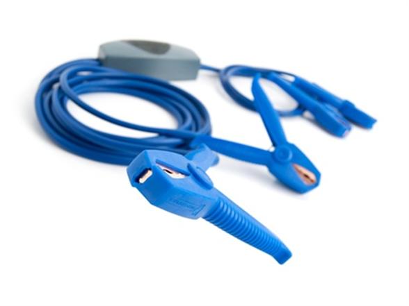

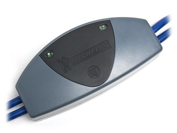

    To that end, I have a set of "smart cables". They are basically cables with a tiny microcontroller inside that sense the polarity on each end of the connection. They also have short circuit protection built in using mast MOSFETs, but I would think they are really IGBTs for that kind of power.
    So you hook up the 2 wires on one end to either terminal and the other 2 wires to either terminal on the other end. After a good delay (1-2 seconds), the cables light up. No sparking, no arcing, no fuss, no worry about having live cables at any point until fully connected, nothing like that. The polarity is automatically detected and they connect. There is no danger to the Prius, they work as normal cables, and are self supplied so no batteries or otherwise. This allows me to jump anything I want with impunity to the Prius electrical system.
    I bought the cables for $17.99 when they were on sale a few years ago and they have more than paid for themselves. Great product, great price, you can't beat it.
